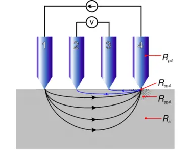

Can you provide a diagram of your electrodes, their connecting wires and your measuring devices?
Are you familiar with the theory of four-point probe resistance measurements?
Schematic of a four-point probe resistance measurement on a grey half-space: four blue probes numbered 1 to 4 touch the surface, with a current source on the outer pair and a voltmeter on the inner pair, and curved current-flow lines spread into the material beneath.
Confusion arises in the first diagram, where equipotential lines cross the deep conductive electrode.
To measure ground resistance, independent of the electrode contact resistance, four equally spaced electrodes are normally used. The outer electrodes are used to insert a current into the ground, while the inner two electrodes are used for the voltage measurement. That eliminates the variable contact resistance of all electrodes from the equation. First study and understand that system.
https://en.wikipedia.org/wiki/Four-terminal_sensing
The four electrode system has been modified to the three electrode measurement, specifically to measure the ground contact resistance of one of the current electrodes.

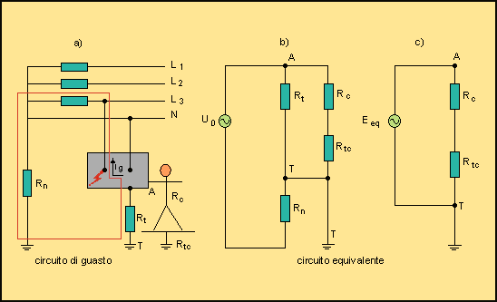

Consider the following TT power distribution system diagram. ##R_n## is the ground resistance of the Neutral (N) grounded at the power grid facility. ##R_t## is the ground resistance at chassis equipment's point A where the PE conductor of the local domestic earthing system is attached to. ##R_c## and ##R_{tc}## are the resistance of the person touching point A (hand-to-feet) and its ground resistance respectively.
Three-panel electrical circuit diagram: a) fault circuit with lines L1, L2, L3, N, a fault arc and resistances Rn, Rt, Rc, Rtc; b) equivalent circuit with U0, Rt, Rc, Rtc, Rn; c) simplified equivalent circuit with Eeq, Rc, Rtc.
Now the point is: how ground resistances ##R_n## and ##R_t## are actually calculated ? I believe they also include the grounding electrode's contact resistance. Then, using for instance the "semi-spherical" model, one is able to calculate the "soil resistance" at a distance R from where the grounding electrode is driven into the earth.
To do that one consider basically a soil semi-sphere of radius R: the "terminals" of such "soil resistor" are the point where the electrode is grounded and the "semi-spherical boundary surface" of radius R.

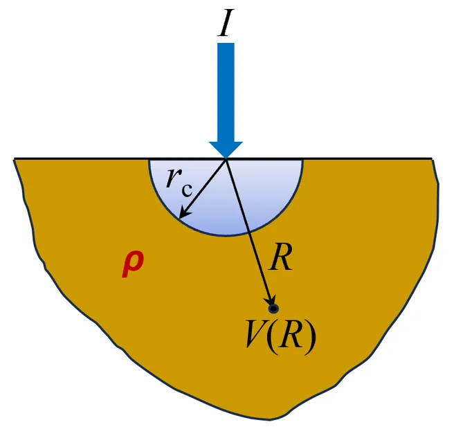

@cianfa72, while that's true, you really don't need to worry about where the contribution becomes negligible since the grounding resistance is exactly calculable for your configuration. Start from your hemispherical grounding-conductor of radius ##r_c## that injects a current ##I## into a semi-infinite body of soil with uniform resistivity ##\rho\,##:
Diagram of a hemispherical grounding electrode of radius r_c in soil of resistivity ρ, with current I entering from above; a radial arrow R points to a point V(R) in the soil.
The voltage field ##V## in the soil is found as follows. By the symmetry of the problem, any hemisphere in the soil that's centered on the conductor is an equipotential surface and so the electric field ##\vec{E}## on that surface is strictly radial and uniformly distributed:$$\vec{E}\left(R\right)=E\left(R\right)\hat{r}\tag{1}$$By Ohm's Law:$$E\left(R\right)=\rho J\left(R\right)\tag{2}$$the current density is consequently also radial and uniformly distributed, so conservation of the current requires:$$J\left(R\right)=\frac{I}{2\pi R^{2}}\tag{3}$$Combining eqs.(2) and (3) yields the magnitude of the electric field in the soil:$$E\left(R\right)=\frac{\rho I}{2\pi R^{2}}\tag{4}$$From this we can find the voltage-difference between the electrode and a point infinitely deep in the soil by integrating along any radius:$$\Delta V\left(r_{c}\right)\equiv V\left(r_{c}\right)-V\left(\infty\right)=-\intop_{\infty}^{r_{c}}E\left(R\right)dR=-\intop_{\infty}^{r_{c}}\frac{\rho I}{2\pi R^{2}}dR=\frac{\rho I}{2\pi r_{c}}\tag{5}$$The total grounding resistance ##Z## is therefore simply:$$Z\left(r_{c}\right)\equiv\frac{\Delta V\left(r_{c}\right)}{I}=\frac{\rho}{2\pi r_{c}}\tag{6}$$
