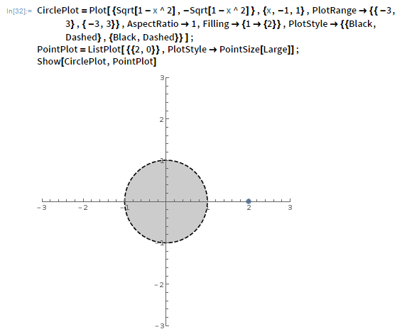

If for example $X=\mathbb{R}^2$ and $D(0,1)=\{ y \in \mathbb{R}^2: ||y||_2 <1\}$ and $x=(2,0)$ then $d(x,K)=1$ and is attained at the point $(1,0) \notin K$.Could you explain me how we deduce that $d(x,K)=1$ ? - if $K$ isn't convex then the uniqueness isn't satisfied.

So $K$ is the open circle of radius $1$, centered at the origin, right? If you visualize the point $(2,0)$ relative to the circle, then the point on the boundary of the circle closest to $x$ is $(1,0)$. However, this point is not in the open circle. Consider the sequence $\{(1-1/n,0)\} \subset K$, and the distance from each of these points to $(2,0)$ in the Euclidean metric. Then those distances are $2-(1-1/n)=1+1/n$. If we take the infimum of these distances, we will see that it is $1$, and hence $d(x,K)=1$.
Could you explain it further to me? (Sweating)

Sure! Let me show you a picture:
Here I've included the Mathematica code I used to generate this plot. Now, the circle is shown filled, with a dotted line, to show that the boundary itself is not included in the circle (it's an open circle). The point is shown on the right with a blue dot. We're trying to find the distance from the point to the circle. Now, imagine any sequence of points converging to the right-most point of the circle, which is at $(1,0)$, and is clearly the point on the (closed) circle closest to the point $(2,0)$. The infimum of the distances from the sequence points to the point $(2,0)$ will be $1$, which is simply the Euclidean distance from $(1,0)$ to $(2,0)$.
Does that answer your question?

Yes, I got it... Thanks a lot! (Smirk)
