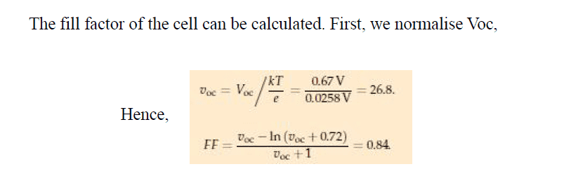

a question about the fill factor of a solar cell
FF = Vm*Im/Voc*Isc
hi guys
for a solar cell i know that the fill factor is given by the following relation :
$$ FF = \frac{Vm*Im}{Voc*Isc}$$

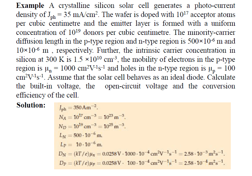

but when solving the following example :
the book used the following relation in the problem?! :
where this Ln relation came from ?
any help on this , i just want a hint how to derive it
