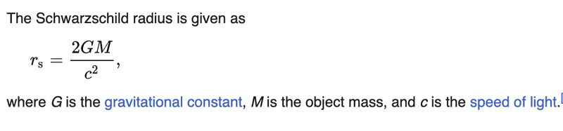

A black hole forms essentially instantly at the moment when its mass is all within the Schwarzschild radius of that mass (named after the scientist who first calculated it in the year 1916), which is given by the following formula:
For a so called "stellar black hole" this happens when you have an object with the density of roughly a neutron star (i.e. close to that of an atomic nucleus) and a mass equal to a cutoff somewhere in the vicinity of more than 2 but less than 3 solar masses (i.e. using the mass of our Sun as a unit of mass), and happens when enough mass-energy is added to a neutron star to take it over that threshold. The exact cutoff has not be determined, but there is a name for this cutoff, which is the Tolman–Oppenheimer–Volkoff limit (sometimes abbreviated as the "TOV limit"). The best estimate is that this is 2.2 to 2.9 solar masses, and theoretical calculations of this are limited mostly by our lack of a complete understanding about how the matter in a neutron star behaves at such extreme gravitational pressures and our lack of knowledge of whether any kinds of matter other than neutrons are found in neutron stars (and if so, how much of what and with what high pressure properties).
