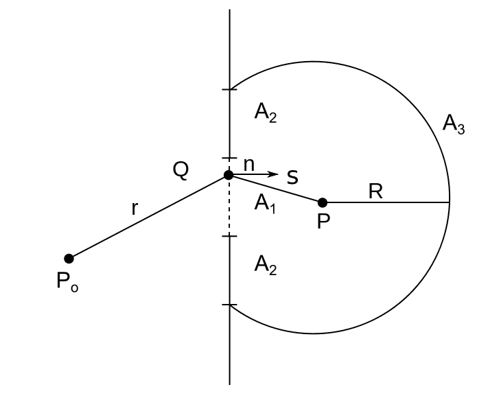

The fresnel-kirchhoff diffraction formula could explain diffraction,I think it should also produce the result with relatively small wavelength and large width slit in which case there is no diffraction.
Diagram of a point source P0 at distance r from a point Q on a planar aperture, with normal n and direction s to point P, and a hemispherical surface of radius R labelled A3, with planar regions A1 and A2 marked.
##U(P)=\frac{ia}{2\lambda}\int_S\frac{e^{ik(s+r)}}{sr}[(cos(n,r)-cos(n,s)]dS##
when ##\lambda##(wavelength) is very small,the ##U(P)## would very large and seems not equal to ##\frac{ae^ir_{P_0P}}{r_{P_0P}}##
One suggestion would be to try it for an observation point that is directly on axis, and use a circular aperture so that the diffraction equations are readily workable. I do expect the diffraction equations for small wavelength and large aperture would give very nearly a shadow when using a single point source on one side of the aperture, but the equations are cumbersome enough, that it might be somewhat difficult to show for the general case.
