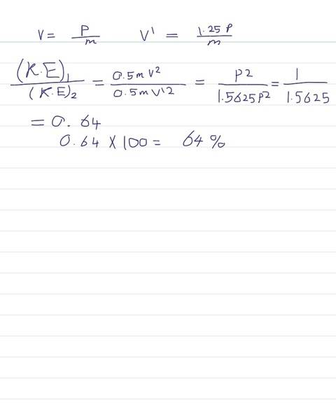

OK, I got 0.64. That means the percentage will be 64%, and the correct answer is 65%. Right?
No. Show your steps, not just he answer.
And: it would be strange if the kinetic energy went from 100 % to 64 % (how do you get 0.64 ?)

Ok, here is my steps, where is the mistake?
Initially, the momentum was p and the velocity was v. Now the momentum is 1.25p, with mass unchanged. So what is the new velocity?

The new velocity is
v = 1.25p/ m
isn't it?

What is the new velocity in terms of v?
Or use actual numbers.
Initial momentum=1, m=1, v=1. Now the momentum is 1.25 with m still equal to 1. What is the new velocity now?

the new velocity (v2) is (1.25v1) where v1 is the original velocity, right?
Or if you want it just in numbers it will be 1.25 since m is still equal to 1, right?

The original question asks for KE2 / KE1 x 100 % - 100 % (the increase in KE in percent)
You had the right answer (1.56 * 100 % - 100 % ) but handled it the wrong way around !
Case solved, onto the next exercise !

Yes. Even if m is not 1, still v2=1.25v1.
Now compute kinetic energy E2. You know E1=1.

E2 = 0.5 m (1.25v)^2 = 0.5 m (1.5625 v^2) = 1.5625 E1
Right?

Right.

What is the 'increase' in energy? What percentage of E1 is that?
Oh, sorry I made a mistake, a very silly one. It will be 0.5625 and when we multiply it to 100 it will be 56.25, so the percentage will be 56% and that's the correct answer. My apologies.

I don't think that's a mistake. E2=1.5625*E1 is correct. This is a 56% 'increase'.
