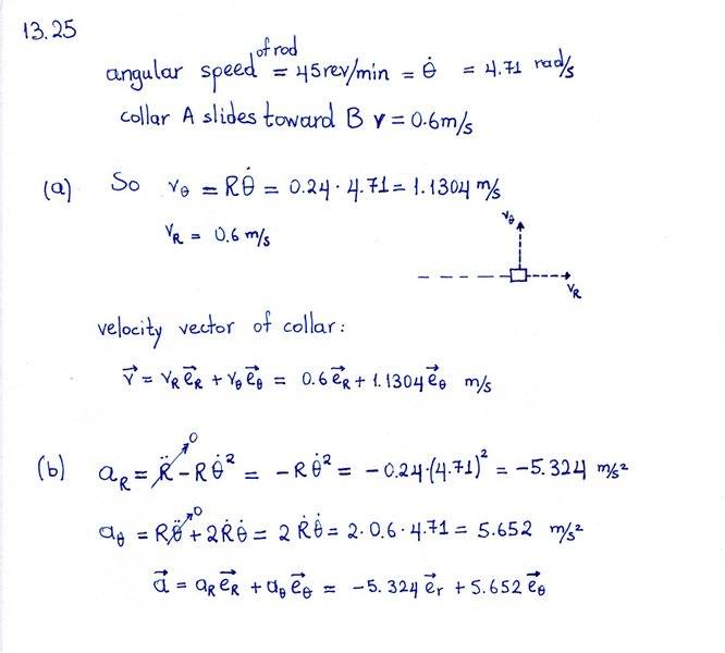

13.25 The rod OB rotates counterclockwise about O at the constant angular speed
of 45 rev/min while the collar A slides toward B with the constant speed 0.6 m/s,
measured relative to the rod. When collar A is in the position R = 0.24m, θ = 0, calculate
(a) its velocity vector; and (b) its acceleration vector.
Handwritten solution to problem 13.25: rod angular speed 45 rev/min = 4.71 rad/s, collar speed 0.6 m/s; velocity components v_θ = 1.1304 m/s and v_R = 0.6 m/s with a small polar diagram; then acceleration components a_R = -5.324 m/s² and a_θ = 5.652 m/s².
Is this correct?
With respect to an inertial or a rotating coordinate system?
