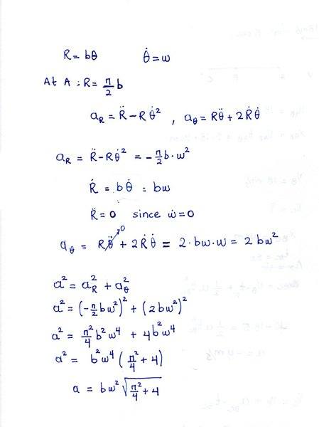

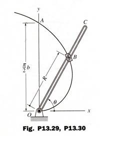

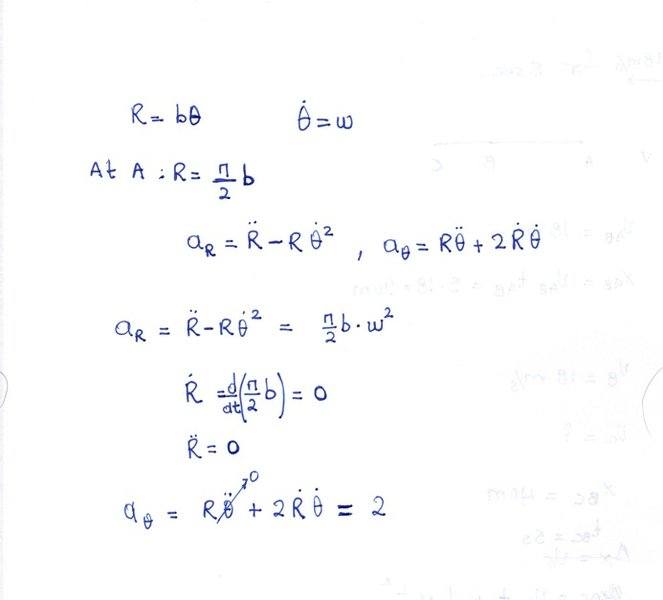

13.29 The colar B slides along a guide rod that has the shape of the spiral R = bθ.
A pin on the collar slides in the slotted arm OC. If OC is rotating at the constant angular
speed ##\dot θ = ω##, determine the magnitude of the acceleration of the collar when
it is a A.

what aθ will be?
It is not 2. I have just left it unfinished.
##\dot{R}## is not zero. Does ##R## not change as the collar slides?
##a_R = \ddot R - R\dot θ^2 = -\frac {π} {2} b ω^2## since ##R = bθ = bπ/2## and ##\dot R = b\dot θ = bω## and ##\ddot R = b\ddot θ = 0##
##a_θ = R\ddotθ + 2 \dot R \dotθ = 2bωω = 2bω^2##
Is this correct? is ##(-\frac {π} {2} b ω^2)^2 = \frac {π^2} {4} b^2 ω^4##
Looks right.
