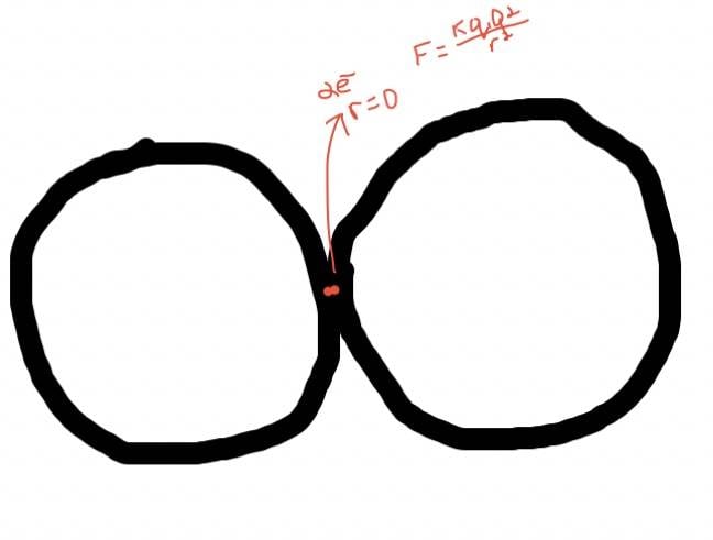

If we have a situation where something like 2 golf balls are touching, aren’t there just other forces at play? If golf balls only experienced the electric force, I would think that the force would approach infinity as they became closer and closer together.
If we two imaginary particles that only had charge and no mass were something like 1/10^100000000000m away from each other there would be an enormous force between them. If one of those two particles were surrounded by other particles that formed a sphere of a radius of 5m, I don’t see how the Shell theorem could apply. A sphere 5m away should apply a much smaller force than a particle 1/10^100000000000m away, even with the additional charges. And if we’re discussing hypothetical particles with only charge, there is no canceling going on.
The "r" in the inverse square law is the distance between the centers, not between the surfaces.
But that’s because of the shell theorem isn’t, which is what I don’t understand. It seems like there should be 2 points on the golf balls where the radius was 0 and force was infinite (if by touching we mean that there is some point with no distance between the two objects, which I know wouldn’t happen). In this situation the force seems like it would have to be infinite, but the Shell theorem seems like it says that it will actually be much smaller.
But the two points have no volume and therefore no mass (as long as the density is finite).
