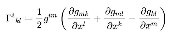

I should add, what led me here was a YouTube video of a man deriving the Christoffel symbols for the surface of a sphere. He took the inner products of the basis vector derivatives with the basis covectors, and I've been trying to understand why he bothered to make sure they were covectors. Will post a link to the video when I find it..
(In that case there was again the complication of using two coordinate systems simultaneously - the phi and theta for the sphere and the (x,y,z) of the Cartesian 3-space.)
If you want to treat this in a proper differential geometry fashion, you should not be using an embedding 3D space at all. All you need is the 2-dimensional description of the sphere (although you typically assume that the metric is that induced by the embedding in ##\mathbb R^3##).
I agree. My interest was to show by example that the covariant derivative of a metric tensor is zero, even in a non-flat continuum. So I wanted the Christoffel symbols for the surface of a sphere. I know one can produce them using that formula with the partial derivatives of the components of the metric, but of course that assumes \nabla g = 0 in the first place.
