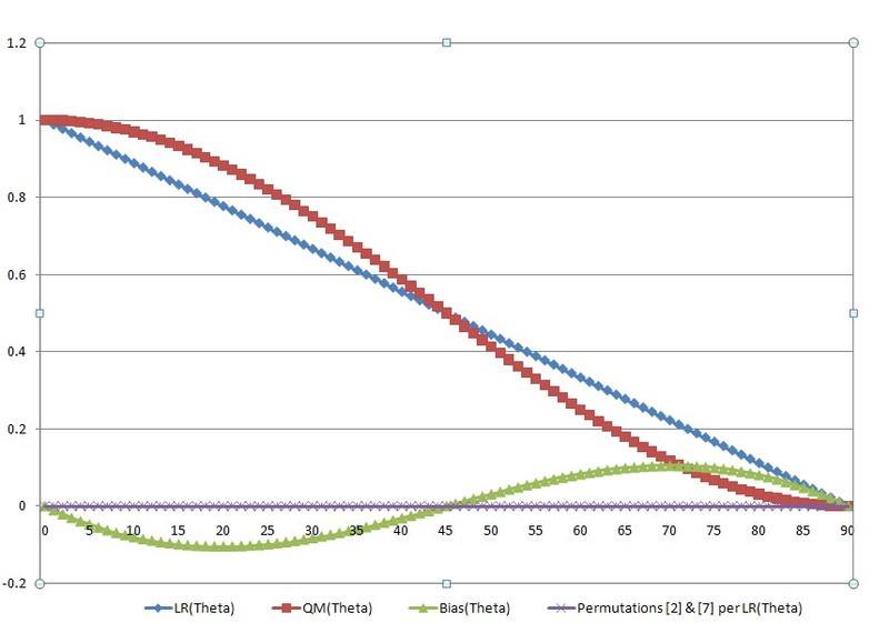

I was interested in discussing what I call the Unfair Sampling Assumption: If the Fair Sampling Assumption and the Locality Assumptions/Loopholes are still open as a pair, then Local Realism (LR) is still viable. I question this assumption! Take a look at this graph:
In the above:
a. We have percentages for a hypothetical Local Realistic (Hidden Variable) Theory, labeled as LR(Theta), showing what it predicts the true correlation percentage is for a pair of entangled PDC Type I photons where theta is the angle between the settings (for spacelike separated Alice and Bob). In the graph, 1=100% and 0=0% per convention.
There is no specific theory this is supposed to mimic except that it is assumed to be local and realistic. If it is local, then what happens at Alice cannot influence what happens at Bob and vice versa. If it is realistic, then it is assumed that even unobserved polarization settings would have well-defined values independent of the act of observation ("the moon is there even when no one is looking...").
The LR(Theta) line, in blue, is a straight line ranging from 1 at 0 degrees to 0 at 90 degrees. This matches the values that an LR would need to come closest to the predictions of QM, shown in Red. Other LR theories might posit different functions, but if they are out there then they will lead to even greater differences as compared to QM. Keep in mind that the QM predicted values match experiment closely.
b. The difference between LR and QM is the detection bias which must exist, which causes us to get an unfair sample (assuming the Unfair Sampling Assumption is true). That is the green line, and you can see that it is positive in one range and negative in another. This is interesting because it means that sometimes it is the LR-supporting pairs which are not detected, and other times it is the QM-supporting pairs that are not detected!
c. Finally, there is the Purple line which goes through 0 at all points (it is a little hard to see on the graph). This is interesting because it is the value of 2 special cases of the 8 possible permutations you get when you have 3 settings (2 which can be actually observed, i.e. Alice and Bob, and the third which is hypothesized by the local realistic theory).
Case Predicted likelihood of occurrence
[1] A+ B+ C+ >=0
[2] A+ B+ C- >=0
[3] A+ B- C+ >=0
[4] A+ B- C- >=0
[5] A- B+ C+ >=0
[6] A- B+ C- >=0
[7] A- B- C+ >=0
[8] A- B- C- >=0
Assuming that we have something like this: A=0 degrees, B=45 degrees, C is between A and B.
It turns out that 2 of the above cases are suppressed: permutations [2] and [7]. The reason is that you cannot have matches at 0 and 45 degrees, but have a mismatch (non-correlation) at an angle in between. The purple line is calculated based on the LRT values (the math is a little complicated and is on a spreadsheet I created). So:
IF you assume that LR has function values closest to QM/experiment, such that you don't run afoul of Bell (since Bell still applies), THEN you get the straight line shown in
BLUE and you also get the values for cases [2] and [7] as being 0 across the board (they need to be non-negative to prove that a Bell inequality is not violated).
Now, here is my question: How can the Unfair Sampling Assumption be viable? In other words, how can Local Realism be viable even considering the Detection Loophole?
By looking at the graph, there are 2 important and conflicting elements for the Realistic view:
1. The Bias() function CANNOT depend on Theta, but it does! If it depends on Theta, then that violates the strict separation of Alice and Bob, which has already been verified! In other words, how can the bias function know to vary as it does unless Alice and Bob are communicating somehow? But that violates locality, which is one of the assumptions of the local realistic view. The Bias function should be constant (proportionally) for any specified detection setup.
2. The Bias function is positive in some places, negative in others. So that means that the detected sample has pairs missing that would give support to LR in some cases, and in other cases it is those that support QM that are missing. You would expect that the bias would ALWAYS be either positive or negative!
I say that there is NO LR(theta) data values which have the characteristic that the Bias function is constant for all Theta. This can easily be seen because both QM and LR must, by definition, have the same value (1) for 0 degrees. That is the QM predicted vaule, we already knew that. But any local realistic theory must also predict 1 for 0 degrees: that is the essence of the hidden variable hypothesis and is necessary so you have perfect correlations at all matching angles for Alice and Bob.
If you have the same prediction for LR() and QM() at 0 degrees, there is no difference. If the Bias function is independent of theta, then that difference must be the same (zero) at all angles. Yet that would violate Bell. QED.
Keep in mind that the above does NOT depend on assuming QM is correct; rather, they merely reflect that the QM predicted values match experiments to date.

How can that be? How can you have a mismatch at the angle between 0 and 45 degrees? In other words, how can one entangled photon go thru the 22.5 degree polarizer while the other does not go thru its 22.5 degree polarizer?
Am I interpreting this correctly? Is this a property of the unfair sampling assumption that you're referring to? That one photon goes thru while the other does not due to equipment inaccuracies?
The mismatch is between the 0 degree polarizer and the 22.5 degree polarizer not between 2 both at 22.5.
Imagine:
Alice=0 degrees and observes a 1.
Bob=45 degrees and observes a 1.
If there had been a Chris at 22.5 degrees (assumed to exist in LR), then Chris must observe either a 1 or a 0. The 1 case occurs, but the 0 case is suppressed. You would probably expect a few 0's but there is no room for those in the graph. The absence of Chris getting a 0 is NOT a proof against LR in itself.

Now this is something new to me: the concept of supression. What causes supression, exactly? What is it? You said, "As it turns out, (2) and (7) are supressed..." :confused:
Forgive my ignorance. Heck, as of last weekend, I didn't even know what a Bell inequality was...
It is interesting, and actually I have never seen any discussion of it at all. But yet it is there, you have to look at the math on my Negative Probabilites page to see it (it is too complicated to repeat here).
http://drchinese.com/David/Bell_Theorem_Negative_Probabilities.htm
See parts d. and f., which I quote briefly:
Why do we pick these particular combinations to define X, Y and Z? Because (X + Y - Z)/2 is the same as the probability of our 2 suppressed cases, [2] and [7] from c. above. We can now see that:
(X + Y - Z) / 2
= (([1] + [2] + [7] + [8]) + ([2] + [4] + [5] + [7]) - ([1] + [4] + [5] + [8])) / 2
Now simplify by eliminating offsetting terms:
= ([2] + [7] + [2] + [7]) / 2
= [2] + [7]
Which means that, if c. above is true, we summarize:
[2] + [7] = (X + Y - Z) / 2 >= 0 (per the Realistic side)
This is true that particular LR function comes closest to prediction of QM but it is chewed over so much that I would suggest to try different function (and hidden variables).
Usually hidden variable is meant to determine in what PBS output it will appear (what polarization photon has). But consider such hidden variable that does not determine PBS output (polarization) but rather "says" that if photon is in output #1 it prefers to be detected and if it's in output #2 it prefers not to be detected. If measurement apparatus perfectly "heeds" what photon prefers then we have almost the same hidden variable as in traditional case except that half of the photons are never detected. But there is additional space for maneuver meaning that measurement apparatus can "heed" partly "detection preference" of photon and differently for different levels of photon "detection preference".
One particular thing of such hidden variable is that for theoretical 100% detection efficiency graph will not be that sloped line but rather horizontal line. It could be sloped line for less than 100% detection efficiency and perfect "heed" of photon preference for detection.
One of the issues is that a candidate LR MUST say what the "true" graph is. There are 2 constraints as I see them:
1. You MUST have LR(0)=1 as this is an explicit assumption of the candidate theory (otherwise you wouldn't be revealing a pre-existing condition common to both Alice and Bob).
2. Further, you CANNOT violate Bell's Inequality. Therefore, there can be no "negative" probabilities.
What you can have, however, is other values that satisfy the above other than the straight sloping blue line. But what are they? I say there aren't any such in which the Bias function is independent of Theta! And you discover very quickly - when you try to plug in another possible candidate function - that you run afoul of Bell. You need the following formula to yield a non-negative value at all points in the range (based on the X+Y-Z formula on my page, ignoring a factor of 2):
Where theta is between 0 and 45 degrees:
BellInequality(theta) = LR(45-0) + (1-LR(theta-0)) - LR(theta-45)
Where theta is between 45 and 90 degrees:
BellInequality(theta) = LR(theta-0) + (1-LR(45-0)) - LR(theta-45)
In case this was not clear before: the above are the formulas for calculating whether Bell's Inequality is violated for 3 angle settings, A=0, B=45, and C=theta. The formula determines the expected values for combined cases [2] and [7], which must in turn be >=0 to be realistic.
I realize that there could exist another attribute which determines whether or not an entangled photon pair will be detected, in the hypothetical LR situation. However, that does not change the fact that the other observables must be real at all times (as that is the realistic hypothesis!) and so Bell applies.
I do not agree with that.
With LR(0)=1 for theoretical SP=100% you imply hidden variable that unequivocally determines observable of polarization.
It is indeed the local realism as proposed by Einstein but it does not cover all possible models of local realism.
QM says that photons are entangled with superpositions of polarization but not observables of polarization. If we heed that statement we should ascribe local hidden variable to superposition itself but not observable.
So from this perspective I say LR(0)=0.5 for theoretical SP=100%.
