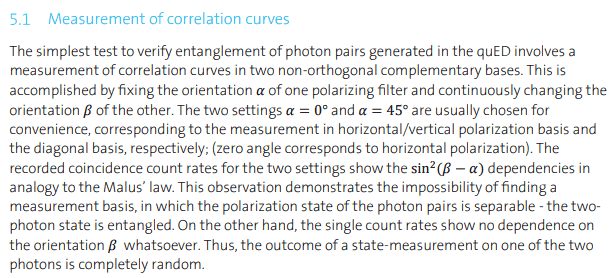

Qutools makes quantum physics kits for educational purposes. Its quED kit is designed to help students learn about entanglement by performing Bell tests. In the manual section 5.1 it describes "the simplest test to verify entanglement of photon pairs."
My question is if the entangled photons have a horizontal/vertical basis as described (where 0 degrees corresponds to horizontal polarization), but the alpha polarizing filter is fixed to 30 degrees instead of 0 degrees as described, would the rotation of the beta filter still result in correlations between the two filter settings consistent with Malus' law such that sin^2 (beta - alpha)? In other words if alpha was at 30 degrees and beta at -30 degrees (or 330 degrees), and the system is set to a horizontal/vertical basis, would the photons be different 75% of the time because sin^2 (-30 - 30) = sin^2 (-60) = 0.75? Or would that calculation only apply if alpha (or beta) were fixed at 0 degrees because of the photon horizontal/vertical basis being at 0/90 degrees? Thank you for any explanation.
Screenshot of a textbook page, section 5.1 'Measurement of correlation curves', describing a test of photon-pair entanglement: two polarizer settings alpha = 0 degrees and alpha = 45 degrees give sin^2(beta - alpha) dependence, while single count rates show no dependence on beta.
Although the nominal notation is HV/VH entangled, the pair respects the usual correlation function at any pair of angles. That being a function of the difference between the two angle settings. By convention, that difference is usually called "theta". A couple of comments:
a. Although the formula sin^2 (theta) closely resembles Malus' Law, it is actually derived independently. I won't include the derivation here, as it is a bit complicated.
b. The other common type of entanglement is HH/VV. Like the other type, it operates at any pair of angles. It takes the form cos^2(theta).

Thank you both DrChinese and vanhees71 - sorry for my delayed reply. I take it from your responses, which I admit I don't fully understand, that in essence the quED kit says that the alpha polarizing filter should be set on 0 degrees at horizontal not because it is required to realize Malus' law and/or the (separately derived) quantum predictions of sin^2 (beta - alpha), it's just that Qutools thinks that fixing alpha at 0 degrees makes the set-up simpler for the beginner like me.
