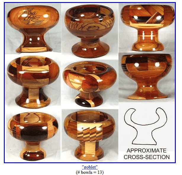

DaveE said:
OK, your turn. List three advantages, I wasn't too impressed with the ones in the article.
1) They would be a lot prettier... :wink:
http://phinds.com/bowls/_master_index.htm
  • Haha
