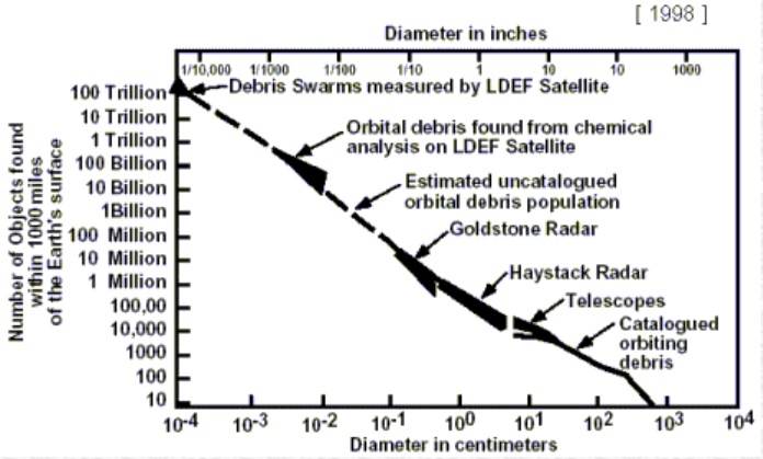

The number of particles in orbit has been measured/estimated as a function of size. This plot, from https://www.spaceacademy.net.au/watch/debris/gsd/gsd.htm, shows the magnitude of the orbital debris problem. You should be able to find newer information by searching Kessler syndrome or orbital debris.

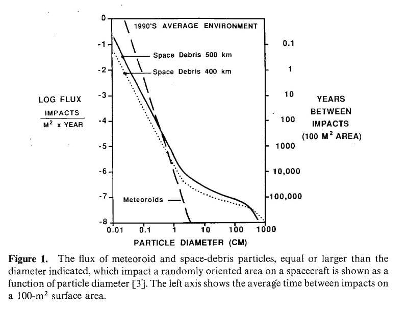

There is some good information on orbital impacts in Structural Failure, by Wierzbicki and Jones. This book was published in 1989, so the numbers are dated, but the impact information should still be good. It's available used from Amazon: https://www.amazon.com/dp/0471637335/?tag=pfamazon01-20.
This plot from that book shows the risk of impact. It also allows the calculation of the necessary size of a particle sweeping system.

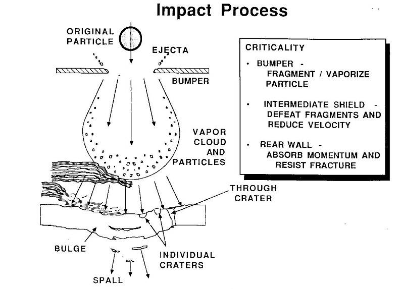

Impacts at orbital velocities are not as simple as a tennis ball hitting the racket. Things get vaporized and fragmented. This figure from Wierzbicki and Jones shows what happens when a particle impacts a multilayer space station wall at orbital velocity.
I think that's the key plot here. If we target 1 cm objects then we get an impact every ~3000 years for a 100 m2 area. A suborbital trajectory will have the sheet in the relevant altitude range for maybe an hour or 10-4 years. To intersect an average of 1 particle it needs an area of 3*109 m2, that's a diameter of ~50 km.
This is from 1990, we do have more debris today, but the required effort per particle is still absurd even if we assume every collision with the sheet will deorbit the debris object.
