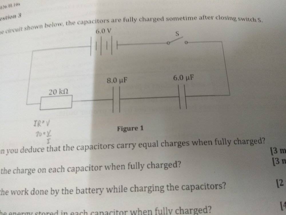

In a circuit, 2 capacitors of 8 microFarads and 6 microFarads are fully charge. These are also connected to 20kohms resistor. What is the charge across each resistor. The emf of cell is 6V
Q=CV
Q1 =Q2 (in series)
I found total capacitance and inserted the total capacitance and emf of cell in equation CV =Q. However I know that there is a resistor connected so that this accounts for lost volts
I assume the question asks for the charge on each capacitor, not the resistor.
Once the capacitors are fully charged, what's the voltage across the resistor?
The voltage across the resistor is V=IR. What is the current in the circuit when the capacitors are fully charged?
The current is not known and hence I can not find the voltage across the resistor
I know it. And so should you! :wink:
How can I calculate the current then?
Should I calculate the current using V = IR by inserting emf of battery and the resostance of resistor. Does however capacitor offer reactance?
Can you send me a picture of the worked out answer because I am confused
If a capacitor is fully charged, is it getting charged further?
The capacitor is fully charged
I don't think you'll get that here. We can help you figure it out. Providing answers isn't the same as teaching.
Have you studied Kirchhoff's Voltage Law (KVL) yet? How can you relate the voltage on the capacitors and battery to the voltage on the resistor?
Once the capacitors are fully charged, what happens to the current? Does it keep flowing? (Where can it go?)
Once you realize what we're hinting at, it will all make sense.
Current is 0 so does this mean that since no current passes through resistor, the total voltage is equal to the sum of pd across each capacitor?
Exactly!
When the capacitors are uncharged and the switch is thrown, current flows until the capacitors are fully charged.
Thanks a lot! Hence, I can use the potential divider rule to solve i.e.
Vtotal/V(of capacitor) = Ctotal/C(of capacitor)
Yes, good work!
