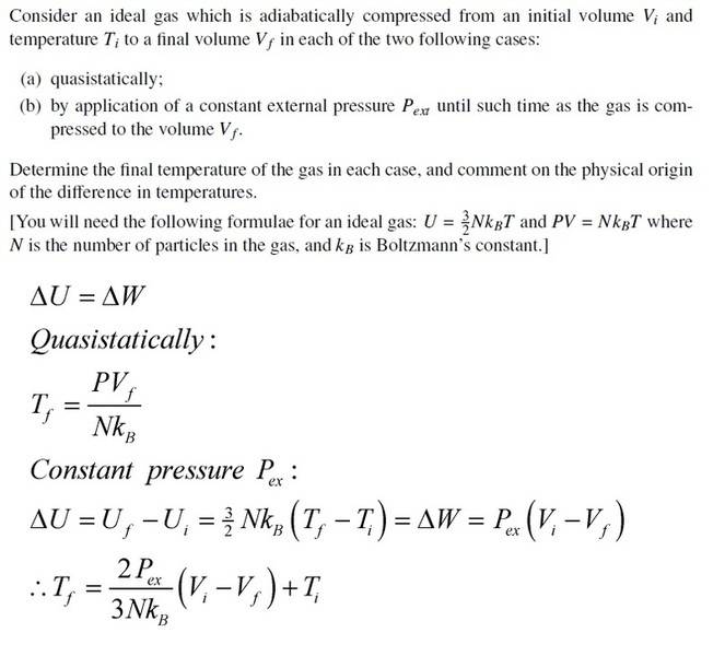

Handwritten-style typeset derivation of final temperature for an ideal gas adiabatically compressed, quasistatically (Tf = PVf/(Nk_B)) and at constant external pressure Pex, giving Tf = (2Pex/(3Nk_B))(Vi - Vf) + Ti, with the energy balance dU = dW shown.
does this look right?
for the quasistatic case you can use thermodynamics to find the temperature at any time,
for the other case you have to use dU=dW and so on since its not quasistatic

It is correct for the constant external pressure. But what is the final temperature in the quasi-static case? It is true that Tf=PVf/(NKB) but P changes during the process. How do you get the final pressure Pf?ehild
Oh right,
so the quasistatic case should be:
Tf=PfVf/(NKB)
for some reason i forgot that the pressure was changing in that case as well,
this makes more sense, in the quasistatic case you can find the state of the system at any point in terms of the state variables, and P is one of those too!
thanks ehild =]

Well, it is not the solution yet. You need to give Tf in terms of the initial and final volumes and the initial temperature. Do you know the equation that governs a quasistatic adiabatic process?

Equation for an adiabatic process: P2/P1 = (V2/V1) raised to the power of negative gamma.
where gamma is the ratio of heat capacities under constant pressure / volume?
Yes. But you can combine it with the ideal gas law to give an equation between V and T.

That is a good start. You can find that constant as you know the initial volume and temperature:
TfVfγ-1=TiViγ-1.
From the equation for the internal energy you can see that it is a mono-atomic gas, so you know Cv, and you also know the relation between Cv and Cp. What is γ-1 then?

Yes, but you made a little error:
Tf=Ti(Vi/Vf)γ-1.
And you know the numerical value of Cp/Cv what is it?

Tf=Ti(Vi/Vf)5/3-1.
Tf=Ti(Vi/Vf)2/3.
