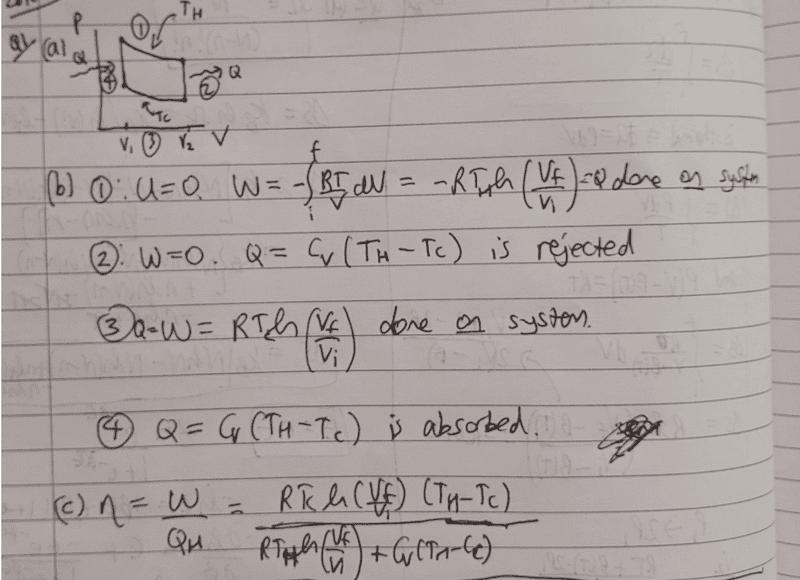

Ok, the problem I was given is this:
One mole of a perfect gas goes through a quasistatic cycle consisting of the following four stages:
1. isothermal expansion from V1 to V2 at temperature TH,
2. cooling at constant volume V2 from TH to TC,
3. isothermal compression from V2 to V1 at TC,
4. heating at constant volume until the system is back in its initial state

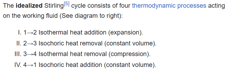

Wikipedia states this for a Stirling cycle:
Ok, so it seems to me they are the same. (I am just including this part because my flaw might be in the assumption that they are the same cycle).

An engine will be a Carnot engine if all processes occur with the system and surroundings arbitrarily close to equilibrium. A Stirling engine cycle is not such an engine.
The work done by any engine over a complete cycle is always ##|Q_h|-|Q_c|##. This is because the system returns to its initial state after a complete cycle so ##\Delta U=0##. So:
[tex]\eta=\frac{W}{Q_h}=\frac{|Q_h|-|Q_c|}{Q_h}[/tex]
For the Sterling engine heat flow occurs on all four parts of the cycle so you have to add the heat flow on parts 1 and 4 for Qh and heat flow on parts 2 and 3 for Qc.
##Q_h=Q1+Q4=nRT_h\ln\left(\frac{V_2}{V_1}\right) + nC_v(T_h-T_c)##
##Q_c=Q2+Q3=nC_v(T_c-T_h) + nRT_c\ln\left(\frac{V_4}{V_3}\right) ##
So: ##W=Q_h-|Q_c|=nR[T_h\ln\left(\frac{V_2}{V_1}\right)-|T_c\ln\left(\frac{V_4}{V_3}\right)|]##
and, since ##V_4=V_1 \text{ and }V_3=V_2##:
[tex]\eta=\frac{R[T_h\ln\left(\frac{V_2}{V_1}\right)-T_c\ln\left(\frac{V_2}{V_1}\right)]}{RT_h\ln\left(\frac{V_2}{V_1}\right) + C_v(T_h-T_c)}=\frac{R[\ln\left(\frac{V_2}{V_1}\right)](T_h-T_c)}{RT_h\ln\left(\frac{V_2}{V_1}\right) + C_v(T_h-T_c)}[/tex]
which can be rewritten as:
[tex]\frac{1}{\eta}=\frac{1}{T_h-T_c} +\frac{C_v}{R\ln\left(\frac{V_2}{V_1}\right)}[/tex]

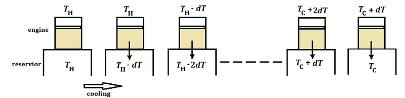

Thus, in the constant-volume process where the engine cools from ##T_H## to ##T_C##, we imagine something like the sketch below. The engine is placed consecutively in contact with the reservoirs.
All heat transfers are between objects which differ only infinitesimally in temperature. So, the heat transfers are essentially reversible. The vertical arrows indicate the direction of heat flow between the engine and the reservoirs. At the end of this process, the reservoirs have gained heat which can be used later in the constant-volume heating process that takes the engine from ##T_C## back to ##T_H##, as shown below:

I don't see this. It appears to me that there is no need to change the temperature of any of the reservoirs.
Andrew Mason said:
Another problem is that you are not operating between a hot and cold reservoir at temperatures Th and Tc respectively. You operating between an arbitrarily large number reservoirs of infinite heat capacity, the reservoirs at Th and Tc being just two of them.
The ##T_H## reservoir does not absorb any heat in the cooling process shown in post #10 but it does give up heat ##dQ## in the heating process. The ##T_C## reservoir absorbs heat ##dQ## in the cooling process but does not give up heat in the heating process. All other reservoirs absorb ##dQ## in the cooling process and give up the same heat ##dQ## in the heating process.
##dQ = C_V dT## where ##C_V## is the heat capacity at constant volume of the working substance of the engine. We can take the working substance to be an ideal gas, so ##C_V## does not depend on temperature. The ideal gas decreases its entropy during the cooling process by the same amount that it increases its entropy during the heating process.
So, for the cooling and heating processes taken together, only the ##T_H## and ##T_C## reservoirs have any net entropy change. Thus, the net entropy change of the universe for the cooling and heating processes together is ##\Delta S_{\rm univ} = dQ(1/T_C - 1/T_H)##. Since ##dQ## goes to zero as the number of reservoirs goes to infinity, we can theoretically make ##\Delta S_{\rm univ}## as small as we like.
