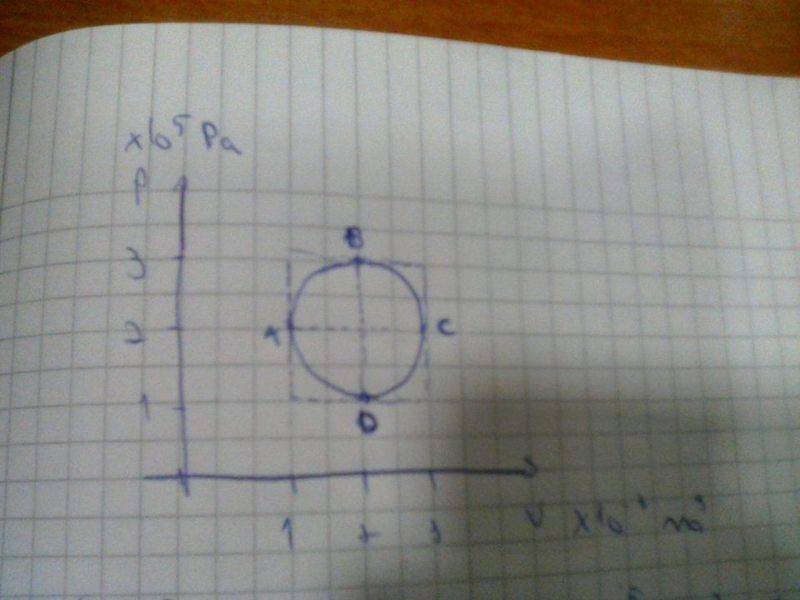

a system uses monoatomic ideal gas describing the following cycle (quasi static)
and basically the p-v graph is a circle,and it starts on the left side of the circle with states A, B, C, D (so that B and D are top an bottom) and so P on A (PA) is equal to PC and VB= VD
given values:
Cv=3/2R
PA=PC= 2*105Pa
PD=1*105Pa
PB=3*105Pa
VA=0.001m3
VB=VD=0.002m3
VC=0.003m3.
what is the work done by the gas?
so iv realized B to C and D to A are isothermal and i can calculate work for those, but the other two arent and they also arent adiabatic.
Im lost. there are so many relations due the first law, i don't know what to do. please a hint.

ok so I've got further questions for this. (pic of cycle added)
1. what is the internal energy difference bettween points A and C
2. what is the liquid heat that passes through the system through paths (a))ABC and (b))AC ( this was exam question i don't fully remember the words used + translation problems)
So 1 seems straight forward for monoatomic ideal gases U depends only on T (U=3/2nRT) i find T for A and C using the state eq. for gases since i have p,v and n.(let R1 be result of this question)
for 2 starting with path AC so b): dQ-Pdv=R1. ----- Pdv= 2*105*2*10-3 and so dQ=dU+pdv
a) since Tc and Tb are equal then dU=0 and so all the U change lies in the path A-B... this i where i get confused... how do i find work for varying temperature, pressure and volume? is this adiabtic an dQ=0?
And for path BC dt=0 so dQ=pdv and again same question work for varying pressure and volume? (do i stil use p=nRT/V and integrate from vb to vc since T is constant here?) ok i just found that this part in parenthisis is correct - so my doubt is path A-B
I'm not sure what "liquid heat" refers to. For part (b), I'm not sure what the path AC means. I guess it means the horizontal path from A to C. Not sure.
OK
You are not dealing with infinitesimal changes here. So, you should write ΔQ - ∫Pdv = ΔU.
Yes, the work done along ABC is ∫Pdv along the circular arc ABC. I don't see any need to break it up into AB and then BC. It won't be of much help to substitute P = nRT/V into the integral since T is not constant in the integration. However, you know from calculus that an integral is related to "area under the curve".

Ok so since the cycle is symetric in relation to line AC i can say that the work done is half of what i calculated when i first presented this problem then i just substitute it into ΔQ - ∫Pdv = ΔU solve for Q.
- new question is there a way of finding work and heat just for AB (without using area under curve)?

Even though states B and C have the same temperature, the intermediate states along the circular arc from B to C do not have the same temperature. So, you cannot treat T as a constant in the integration.
No, the work done along arc ABC is the area under the arc that extends from the arc all the way down to the V axis. So, it is not half the area of the circular cycle.
Yes.
The only way that I can see to get the work for AB is using W = ∫PdV. The easiest way to get the value of the integral in this problem is to find the area. But, you could also use the fact that the path is along a circle to find an expression for P as a function of V. Then substitute for P in ∫PdV and do the integral. But that takes more work effort than just finding the area.
