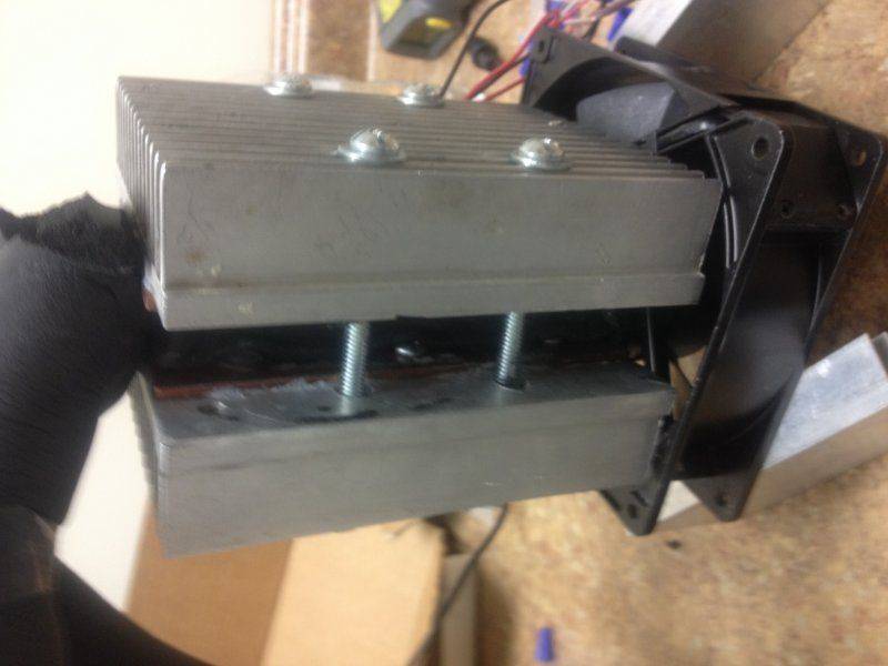

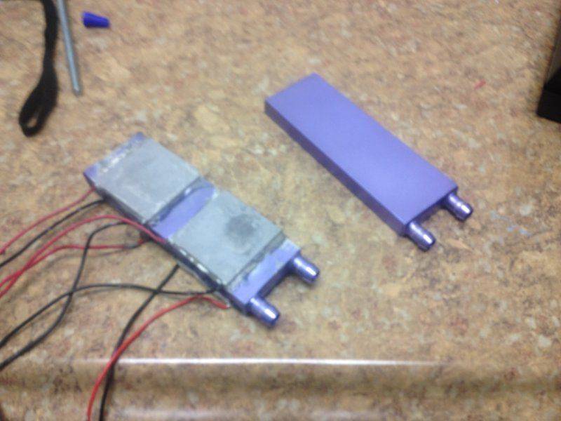

I agree that I am picking up significant heat somewhere and I'm also not sure that my expectations may be too high. Attached are a couple pics showing my setup. One shows the liquid heat exchanger new as well as one which I had 4 modules attached, two on each side making it double sided. The one I'm currently trying is set up the same way except I'm using 6 of a TEC1-12706 module. In the second picture you see is this assembly sandwiched between two heavy aluminum heat sinks with a 1/8 copper plate that is 3x the area of the cells used as a thermal spreader.
All surfaces use Phobya thermal grease which claims to have a very high thermal rating, 16 W/mK. I have a fan blowing air thru the heat sink with a makeshift cowling around it to direct the air flow across the heat sinks. Using a small pump water is circulated thru the unit and into a 20' trunk that insulated with 1" elastomeric pipe insulation with an outside diameter of 2.75".

I'm going to hand make the trunk for this application and retry. I also see a few thing I can do with the unit to make it more efficient. Mill out the liquid heat exchanger and thermal epoxy the TECs so the water is in direct contact with the cold side. This should reduce my delta T. Trim away the insulation on the side of the exchanger that is in contact with the hot copper thermal spreader because it would appear the heat is being recycled back to the exchanger thru the insulation. Is there a better insulation that could be used in an application where it must be very thin?
