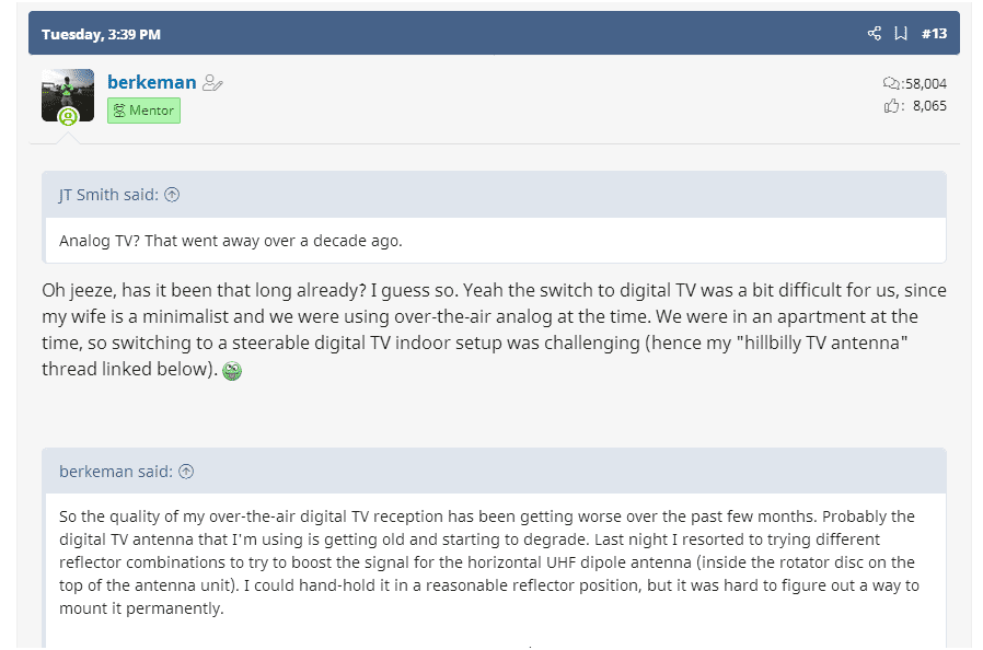

  • #31
JT Smith said:
We have kind of the reverse problem. Since we don't watch very much TV we've shunned the expensive cable company and stuck with over-the-air TV for years. The number of channels is limited but it's worked okay... until the last few years. The number of channels we can get, even with excessive adjustment and moving of the indoor antenna, which we have replaced twice, has been steadily decreasing. Some channels are now completely gone; others are just too noisy. Some would probably have been watchable as degraded analog channels but a digital channel just falls apart when enough is missing.
We are perplexed as to why. Sometimes a channel looks good and then, without any rhyme or reason, we have to struggle to watch it at all. Streaming isn't that expensive. And we have access to free movies. But what's going on?
The conspiracy theory part of my human brain thinks that the cable company is somehow responsible. But it's probably some other source of modern interference. I just have no clue what. Our neighbors WIFI? Cell phones in cars driving by? Something from the nearby transit hub? I don't have, nor am I likely to think it affordable, to buy whatever hardware is necessary to track it down. I don't mind being in the rain. Is there some not-too-expensive way to debug this? Audacity??
You should probably get an outdoor yagi antenna unless you're very close to the stations. They may have reduced power for some reason.

  • #34
Baluncore said:
But there is little point in discussing systems that use indoor antennas, they are designed for looks, not performance.
Sort of. The Fractal Antenna Reflector post that I linked above was in an apartment. You are not allowed to drill holes in the walls to make coax feedthroughs when you live in an apartment. I did have attic access (very tiny), so I did briefly consider trying to route something through the attic, but not for long. o0)
