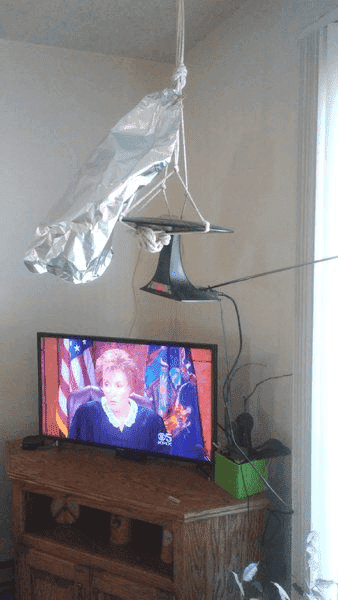

berkeman said:
So the quality of my over-the-air digital TV reception has been getting worse over the past few months. Probably the digital TV antenna that I'm using is getting old and starting to degrade. Last night I resorted to trying different reflector combinations to try to boost the signal for the horizontal UHF dipole antenna (inside the rotator disc on the top of the antenna unit). I could hand-hold it in a reasonable reflector position, but it was hard to figure out a way to mount it permanently.
So I went the fractal reflector route shown in the picture below (the antenna unit was already hanging from the ceiling). It actually worked a lot better than I expected, but it probably won't work for all stations (since you have to use the rotation function to find the best direction to point the UHF dipole in the disc -- the local stations are spread through about a 90 degree arc to my north.
Anyway, it looks like it's time to spring for a new over-the-air digital TV antenna. We live in a 2nd floor apartment and the TV is next to the balcony, so I could probably camouflage a fairly large antenna below the railing if that would help. (I already have a camouflage HAM radio antenna on the balcony). Does anybody have any suggestions for good digital TV antennas (USA models)? Clearly it needs to have rotational capability (or phased array capability, if that exists for digital TV antennas).
Thanks for any ideas! :smile:
Very creative. And I am not above "hillbilly" tactics.
But I'm more interested in what is affecting the previously acceptable signals. Some have degraded over time and others are degraded for shorter periods at what seems like random times. We have twice replaced the antenna, even trying one with an amplifier. Sometimes it doesn't matter where you stand holding it.
Something is interfering. I'd love to know what but have no idea how to figure it out.

Still wish I knew what was messing up the signals. Something in the environment changed.
Or the coax cable is gradually filling up with water.
