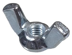

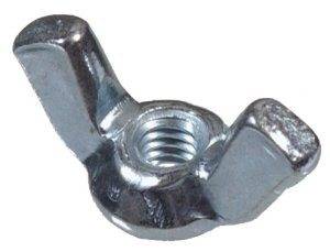

Maybe use a wingnut with stops?
http://ecx.images-amazon.com/images/I/41OKwQ0IBSL._SX300_.jpg
I'm confused. What's unique about the threads of a wingnut? Are you suggesting I use the "wings" against a stop?
I'm using a pin on the axle and a slot in the nut now.

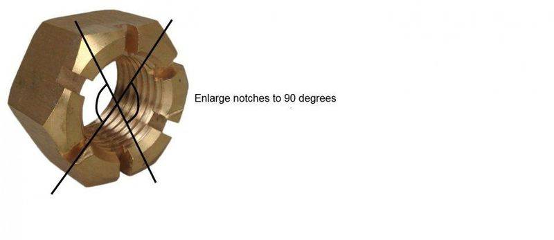

Perhaps use a pin that is smaller in diameter than the notch in the nut.
Diagram to follow.

Don't get too excited. Not sure it's accurate enough for what you want. I was just thinking of enlarging the notches in a castellated nut to allow it to rotate 90 degrees...
