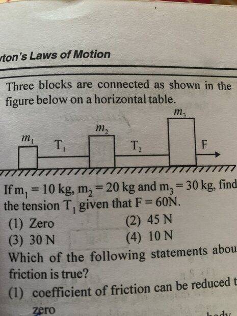

Three blocks are connected as shown. If m1=10 kg, m2=20kg, m3=30kg, find tension T1 given that F=60N
F=ma
Since no body accelerates so net force is zero. Force on each mass is zero. T1 and T2 both are 60N.
Edit: since there is a force applied so there is acceleration on friction less surface.

How do you know there is no acceleration? Why have you assumed this?

Neither is it stated that there is no acceleration. Maybe that's because you can work it out from the given facts. Let me see, there is only one external force with a horizontal component...

Did you notice the plural form? There are 3 free body diagrams to make, that will give you 3 equations with 3 unknowns.

One only needs to know the common acceleration of the masses to find ##T_1## which is the only horizontal force acting on ##m_1##.
Of course, since friction is not mentioned or implied, one has to assume that it doesn't exist. To be fair though, how can the OP, who is not familiar with problem statement conventions, deduce that acceleration (which is not mentioned) must be non-zero, yet friction (which is also not mentioned) must be zero? Given what is omitted from the statement of the problem, it is entirely possible to have zero acceleration if the coefficient of static friction is large enough, or the coefficient of kinetic friction has just the right value. Saying that the contact is frictionless costs nothing but it provides clear indication to someone, who doesn't know how to read between the lines, that the acceleration cannot be zero.

To @rudransh verma : Can you post the entire problem and not just a piece of it?

Friction does not need to be zero.
That's exactly my point. If the friction does not need to be zero, the acceleration can be zero or non-zero.

My point is that the answer should be the same for a wide range of friction coefficients. Unless my intuition is failing me here, only the static case would possibly give a different result.

T1 = 10N
As @Orodruin has previously pointed out, the tension, T1 does not depend upon the coefficient of friction provided that this is not the static case.
(It should be noted that the only other requirement for this to be true is that the coefficient of friction be the same for all of the blocks.)
The coefficient can be zero. It can be small. It can be large. It can be such that the acceleration is zero. In any case, if the blocks are sliding on the surface, any of these scenarios gives the same value for T1 .
The point of this problem as I see it is to be able to make assumptions and test if those assumptions make sense or not. Is there friction or not and what kind of friction? Is there acceleration or not and under what circumstances? One has to make an assumption and test if it is consistent and then make another if the first doesn't lead to a consistent answer.
I see five simple cases to consider.
1) No friction. This is easily solvable.
2) Static friction.
i) The static friction on each block is less than the maximum allowable by the materials involved.
ii) The static friction is at the maximum possible value.
3) Kinetic Friction.
i) The acceleration is zero but the velocity is not.
ii) Both the acceleration and velocity are non zero.
Each case is either solvable with the given information or it is unsolvable. All solvable cases lead to the same answer for the tension of ##T_1## but under different assumptions. The unsolvable cases just tell you what you would need to solve it in that case but since that information is not provided you cannot solve it but can assume the problem is not one of those cases. In other words, you still learn something. I would encourage you to try and work each case one by one to fully understand how to approach such a problem.
BTW, It would be nice to see the whole problem.
