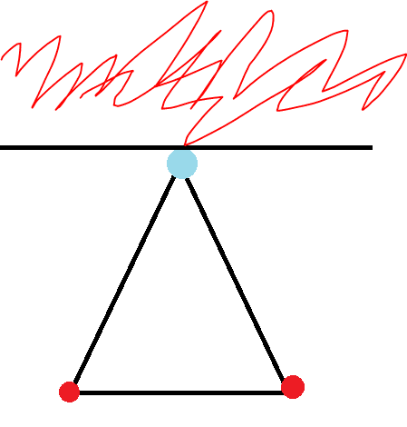

Two positive ions and one negative ion are fixed at the vertices of
an equilateral triangle. Where can a fourth ion be placed, along the
symmetry axis of the setup, so that the force on it will be zero? Is
there more than one such place? You will need to solve something
numerically.
Coulomb's Law would be enough.
Actually we find the two position in the axis very easily, but, what am trying to find is if exist such position (Being the charge of the ions equal) away from the symmetry axis, but i really don't want to try find it numerically, it would be a disaster.
The only conclusion i got is, if such position exist, it should be somewhere in the red region of the figure:
The blue charge is negative
The red positive.
There is a way to prove if exist or not this position? Without the math would arise?

I sketched the field lines. It seems to me there can only be the two saddle points.

Assuming all three charges have the same magnitude, there will will always be a saddle point in the potential near the midpoint between the two like charges, just a little further away than that from the third charge, and another on the far side of that third charge, roughly twice as far from the like charges as from the third charge.
For each of the combinations of of one charge and one saddle point, there is a unique field line connecting them. Using the diagram layout, there is a field line from the lower left charge to each saddle point, and a straight field line from each of those to the top charge. Together, these lines bound roughly a semicircle. Inside that, all field lines run from the lower left charge to the top charge. This leaves no possibility of another saddle point in that region.
Etc.
