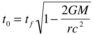

To illustrate then, without accounting for the effects of rotation, proximity to the Earth's gravitational well will cause a clock on the planet's surface to accumulate around 0.0219 fewer seconds over a period of one year than would a distant observer's clock. In comparison, a clock on the surface of the sun will accumulate around 66.4 fewer seconds in one year.https://en.wikipedia.org/wiki/Gravitational_time_dilation
