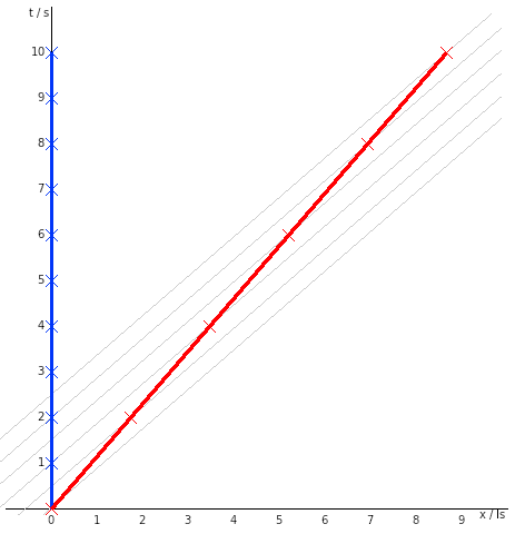

Minkowski spacetime diagram with x in light-seconds across and t in seconds up; a vertical blue line at x=0 with ticks at each second, and a red line at about 0.87c with ticks every two seconds, plus faint diagonal light-cone lines.
And this is the answer to your original question. The traveller's last "now" line, what the traveller calls "all of space 5s after I passed the stay-at-home", passes through the stay-at-home's (blue) line half way between the stay-at-home's 2s and 3s tick. That is, according to the traveller, the stay-at-home's clock ticked 2.5 times "during" five ticks of his own clock, while according to the stay-at-home their clock ticked ten times while the traveller's ticked five times. This is not a paradox: they just mean different things by the word "during", and neither is wrong.

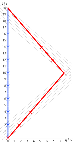

This is also the resolution to the twin paradox, with which you are confusing the above scenario. Let's add a return leg to the above diagram to turn it into the twin paradox:

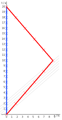

Minkowski spacetime diagram with time t in seconds on the vertical axis and x in light-seconds on the horizontal axis, showing a blue vertical worldline at x=0 and a red V-shaped path going out to about x=8.7 at t=10 and back to x=0 at t=20, with tick marks and thin grey simultaneity lines.
The stay at home says that "during" the outbound leg the traveller's clock ticked five times; the traveller says that "during" the outbound leg the stay-at-home's clock ticked 2.5 times. And we can draw the "now" lines for the traveller on the return leg too:

There are more sophisticated ways of defining "all of space at one time" so that you don't get funny time skips like this (indeed, any approach that yields time skips is basically a mistake). I'm not going to go into them because the maths is a lot messier and this post is long enough already, but there are several ways to do that.
