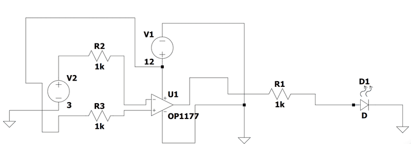

i want to detect 12V supply is ON or OFF using the operational amplifier
I want to detect the 12V supply using the LM358 opamp, the schematic is as below and i also want to drive the LED. I have attached the asc file. As of randomly i have selected 3V for 12V detection.
Similar circuit i want to use for detecting the CAN signals, the CAN_H voltage is 3.5V and CAN_L is 1V and turn ON the LED accordingly. Please let me know if the above circuit works.
When simulating i observed that i cannot use the same 12V supply, i have updated as
another 12V supply which is the actual signal. I get output as 10.8V.
There are a few problems.
1. You are using the 12V supply for the op-amp. If the supply is not there, the op-amp will not work. This is what I call self-referential logic.
2. The input to the (+) input is from the supply rail, which is probably outside the common mode input specs of the intended LM358 op-amp. The LM358 works well near the neg supply rail, not well within 2 volts of the pos supply rail.
3. Op-amps do not work well as comparators. Op-amps like their input voltages to be within about 100 mv of each other. Comparators don't care what the inputs do.
There is probably no need for an op-amp here. It could be done with a current regulator and an LED.

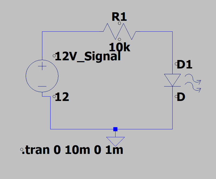

Can i use the below circuit
with 10K resistor (for low current consumption) and when 12V is available the LED will be ON.
PhysicsTest said:
Can i use the below circuit ...
Yes.
The LED will start to glow at about 3 volts and get brighter as the supply voltage rises.

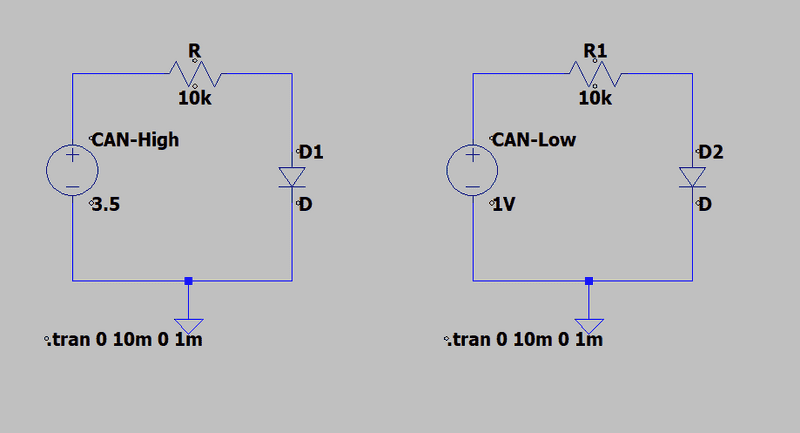

To detect CAN-H and CAN-L is properly communicating i need to verify if the CAN-H line at 3.5V and CAN-L line at 1V. I will use the below 2 circuits
will it be ok? For D2 the forward voltage drop i will select as 0.7V.
Where is the LED in the circuit?
I think you are forgetting that a couple of volts will be dropped across an 'on' LED.
I actually mean to put an LED in place of Diode i took wrong part number from LTSpice. I never intended to put a diode.
To detect 12 volt B+, CAN-Hi and CAN-Lo, will require different circuits.
Are you trying to detect a missing CAN signal with an LED indicator?

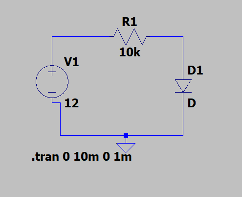

Why do you want to use an op-amp to do this?
Here's an alternative:
You might just leave out the zener if you really only care about on/off.
Normally, this sort of digital signal would use a comparator instead of an op-amp. If I thought I needed op-amp features, then I would include some positive feedback/hysteresis. But, then, I don't really know what your application requires. If you want a simple approach to precision, look into the TL431. It's a great, old, common, and cheap part for this sort of circuit. If you don't use it here, you'll probably want to use it another time.

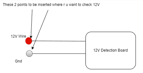

The application is in a commercial vehicle where many ECUs are connected and in case the vehicle is break down, the first thing is to ensure that 12V is coming to all the ECUs, so open each ECU connector identify the pins where 12V shall come, then insert the detection circuit with 2 wires (which is planned to do) one in positive and the other ground and verify with LED if the 12V supply is coming or any loose contact.
Then the circuit by DaveE in post #11 above would do the job.
https://www.physicsforums.com/posts/7251874
I would suggest that their be a connector on your test circuit to mate with the cable connector. That way you are not depending on the operator to get the right pins.
