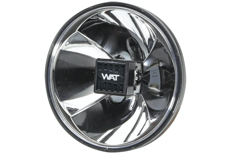

Okay, first off is an image of the light in question from the manufacturer:View attachment parmetheus-pro-par-46-featured_2048x2048.webp
You can kinda see one of the diodes there, pointed out into the reflector bucket. The black core structure is both support structure for the forward lens and heat sink. It's screwed to the back shell by a pair of screws that also help hold the driver board in place.

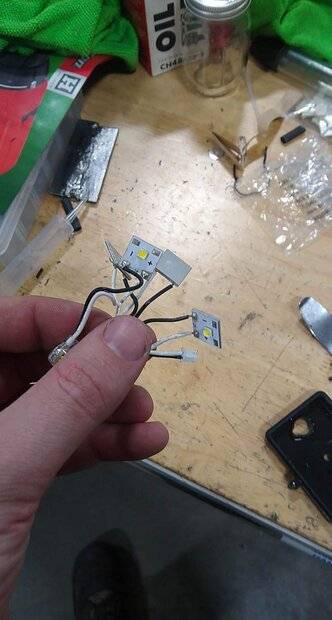

And these are the LED chips:
Hand holding two small square LED modules on a workbench, each with a yellow-tinted chip and wires connecting them, with a black plastic part and scrap items nearby.
(Please forgive the messy toolbox top in the background.)
Chips are wired in series, joined by splices. Chips are ~ 1/2" on a side. Backing plate appears to be aluminum, and has small spots of residue from thermal paste.

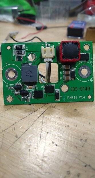

For good measure, I'm throwing in a shot of the driver board, too:
Green LED driver circuit board labelled PAR46 V1.4 and 909-014D, with a white three-pin connector, a red-cased inductor, a black inductor marked 150 1914, and surface-mount components.
C1 is what got snapped off. For scale, holes are for #8 screws on the positive and negative pads, and #6 for the mounting points.

Does your DVM have a "diode" setting? If so, you could verify if each module has a Vf of about 1.5-2V and hence is a single LED junction and not several in series...
I know the one in my toolbox does, will have to see if my home one does or not.

It looks like one end of C1 is connected to Minus Supply (Gnd), with the other end connected to the junction of two 150Ω resistors in series. It is difficult to tell for certain from the photo, the labelling for C1 is in the way. Anyhow, if that is the case, it indicates that C1 is likely part of a Pi filter for whatever the resistors are supplying power to.
Try connecting a 1μf to 10μf capacitor to the C1 pads. Capacitors in that value range are usually electrolytics, so get the polarity correct... otherwise the go 'Bang.' (sometimes with shrapnel)

I’ll take a look tomorrow at the board under magnification. I think I understand what you’re getting at... looking at the traces on the board.
Flyboy said:
I broke off a surface mounted component on the driver board during the dissection of the light.
That looks like a clean break. Any intent on a repair instead?
I would start with piling up 10u 50V ceramics there till it starts working.
