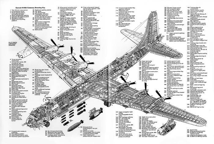

One of the largest aircraft ever built in series production used the pusher prop layout. I'm talking the 'Aluminum Overcast', the B-36 bomber:
This plane featured an unusually thick wing, so thick in fact that a crawl space in the wing allowed the crew to crawl out to the reciprocating engines and service them during flight. This unusual propulsion arrangement was chosen because if the propellers were fitted in the more common tractor configuration, it would have upset the airflow over the wing too much. Early models of this aircraft flew with only the 6 propeller arrangement; later models had four jet engines fitted to provide additional speed over the target and to help get this beast off the ground. When everything got going, the B-36 had 'six turning and four burning' when it started its takeoff roll.
