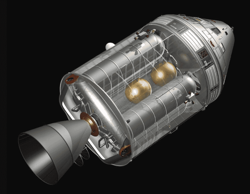

No, that doesn't follow. I expect that every nozzle would work in space. In fact I think it impossible to eject mass in a weightless vacuum without some reaction force acting on the craft. That is Newton's 3rd law.
Edit: This is the Apollo Command module. It was designed to operate only in space. You can see the nozzle.
Cutaway cutaway render of the Apollo service module showing internal tanks and spherical pressure vessels, with a large conical engine nozzle at the left end.

You don't seem to sure as you only 'expect' every nozzle to work in space rather than 'does work in space'.
With the greatest respect showing the Apollo module is not proof if you are a skeptic since there are many examples of false and inaccurate information regarding space travel.

You don't seem to [sic] sure as you only 'expect' every nozzle to work in space rather than 'does work in space'.
This post in this thread has earned you a pretty stern infraction, and your trolling in this thread is not appreciated. The thread will remain closed.
