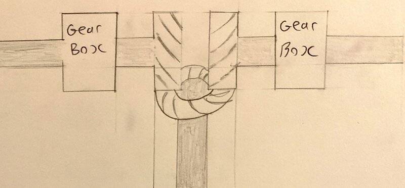

How do I transmit power from two shafts, rotating in the opposite directions at different speeds to one shaft perpendicular to both of them?

You have a 'mystery transmission element' in the picture. You mean you're not allowed to put gears or other moving parts inside that? If you are, then what restriction is preventing you from doing so?
no
i can put anything in the mystery area
I'm afraid a mystery area containing a vacuum is probably not going to meet your needs.
Do the two input shafts have to be coaxial? If you can offset them a bit from each other perpendicular to their axes, that would make it simpler.
yes i can move them anywhere but they have to remain horizontal
1) I misread your reply and thought you said there could not be anything in there. Hence the vacuum reply. Scratch that.

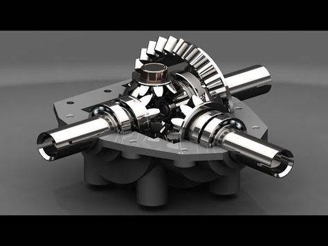

2) If you can put anything in there, put in a gear to reverse the rotation direction of one of them, and then put in a differential, just like the one on the old rear-wheel drive cars, and only a little different than the one on the front-wheel drive models. Both serve the same purpose, but only the former has one shaft perpendicular like that.
I know all about differentials, having built a couple out of toys, and having melted one in my Grand Marquis. It was a sight to behold

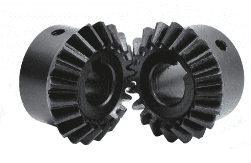

Great. If you offset them you can use fairly simple gears in that transmission, IMO. Offset one shaft up and the other one down and use bevel gears or similar to couple the two input shafts to the output shaft. If the two input shafts need different gear ratios, use separate bevel gears to do the coupling.
https://m.media-amazon.com/images/I/613n+C3ARML.jpg
Actually, if the different gear ratios are the only issue, then you may be able to just offset one of the input shafts up the output shaft a bit to couple via a different set of bevel gears with a different ratio compared to the bevel gears at the end of the output shaft...
Let us assume that the perpendicular output shaft speed must be the sum of the speeds of the two counter-rotating, independent, input shafts.
1. Three bevel gears.
2. One reversing gear and a differential.
3. Two hydraulic pumps, in parallel, driving one hydraulic motor.
4. Two DC voltage generators, in series, driving a DC motor.
5. Two shaft encoders, a microcontroller, and a servo or stepper motor to drive the output shaft.

for 1.
How could 3 bevel gears work here?
if one is mounted on each of the shafts and the input shafts both interlock with the output shaft then won't the input shafts just subtract from each other?
(here's I have artistically illustrated how I imagine ur three bevel gear idea. ignore the gearboxes )
It is the simplest, but limited solution. The bevel gears would need tooth counts that allowed for a fixed ratio of input shaft speeds.
Since the input shafts are counter-rotating, the subtraction would become an addition.
The constraints on the speeds of the input shafts are unspecified.
Are they operating at a fixed speed ratio, or are the speeds quite independent.
