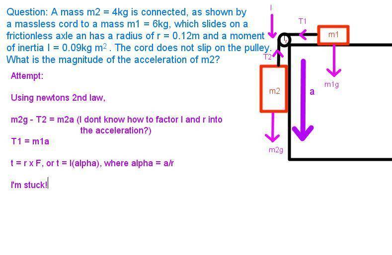

Question and data in attached diagram.
Also in attached diagram.
Again, in attached diagram.
I can't establish the link between the rotation inertia and radius of the pulley into how that effects the acceleration of my 2 block system. I'm assuming you have to use the torque or angular momentum to work it in there?

Write Newton's 2nd Law for the pulley. That will give you a relation between the tensions on the two sides.
Torque = rxF ; F = T2-T1
Therefore torque = rx(T2-T1), Thats the only thing i can think of...
bump, I don't know how to use Newtons 2nd law on the pulley :/.
Torque corresponds to force, I to mass...
