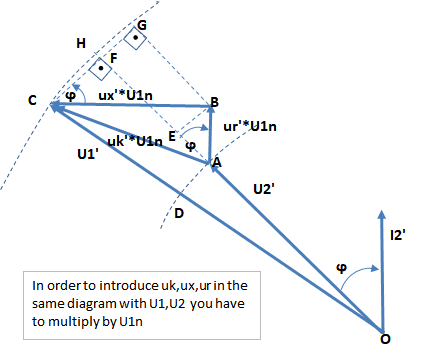

Hello everyone! I'm currently studying transformers and a task related to phasor diagrams shows up. I'm having lots of problems with comprehension of the subject, so I'd like to ask for some help. I don't understand how the phasor diagram given as a solution could possibly be drawn out of the computed data.

  8. This equation is given on the datasheet and it describes the voltage drop on secondary side ##\Delta U##. It can also be derived from the Kapp triangle using points on the diagram (will attach it below). Computational procedure is $$\Delta U = U_2 \cdot (
    u'_{R}\cos\phi_{2}+u'_{X}\sin\phi_{2}+U_{1}-\sqrt{U_{1}^{2}-(u'_{X}\cos\phi_{2}-u'_{R}\sin\phi_{2})^{2}}\cong4\text{\%}) = 17.6\text{V}$$ meaning that ##U'_2 = E'_2 - \Delta U = 422.4\text{V}##
Now if we take a look at the phasor diagram (should be attached below), proportions don't add up, because if ##U'_1 = 1100\text{V}##, then how can ##U'_2##, which should be ##422.4\text{V}##, be drawn as if it measures ##\approx 660\text{V}##?
Any sort of help would me more than appreciated.

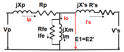

From the attached Single-Phase Transformer Diagram where:
Vp=primary rated voltage
Rp=primary windings resistance
Xp=primary windings magnetic flux leakage reactance
Xm= main magnetic flux reactance
Rfe= equivalent resistance of magnetic losses
Ip=primary load current
Io=primary windings main magnetic flux current
I's=secondary current referred to primary
V's=secondary terminals voltage referred to primary
R's=secondary windings resistance referred to primary
X's=secondary windings leakage reactance referred to primary
E1=e.m.f of primary windings
E'2=e.m.f. of seconadry windings referred to primary [E'2=E1]
Zp=Rp+jXp ; Z's=R's+jX's
Po=Rp*Io^2+E1^2/Rfe where E1^2/Rfe=Pcore
Pcore=Core loss = Hysteresis loss + Eddy current loss
Pcore=Kh.f.Bmax^n+Ke.f2.Bmax^2
If we could neglect Rp*Io^2 then Po=Pcore
If we shall neglect hysteresis loss then only eddy current loss will be:
Po=Ke.f^2.Bmax^2
Bmax=k.E1/f/Areacore
Po/Pon=Ke.f^2.Bmax^2/Ke.f^2.Bmax^2=(f/fn*Bmax/Bmaxn)^2 or:
Po/Pon=[f/fn.E1/E1n.fn/f]^2=(E1/E1n)^2
E=Vp-Zp*Ip=V's+Z's*I's
In order to calculate E we need to know Zp or Z's.
In a short-circuit case E1=E2≈0 then Zsc=Zp+Zs'
Zsc=Vp^2/S.uk%/100
So what we can know it is only Zsc and we don't know what is Zp and Zs' separate.
Let's say Zp=Z's=Zsc/2
Now we could calculate E1/E1n and recalculate Po.
The resistance and reactance it could be considered constant.

This was actually incredibly helpful! Thank you for your time and patience! I finally understand how it works, thank you!
