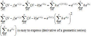

I am not sur to well understand the wording of the question and what you did.
My joint answer might be to easy :

I would start by replacing j by j'=N-j and k by k'=N-k, also note that sums in both cases go from 1 to N.
Next note that Σkxk = xd/dx(Σxk) = xd/dx(1-xN)/(1-x))
Now evaluate the derivative and substitute e±iy for x in the appropriate expression.
Thank you very much, this seems to be the easiest, and also most elegant, solution.
Just the last question, the sum can also go from 0 to N? It should make no difference since for [itex]j = 0, j\cdot e^{ijx} = 0[/itex]
You are right.
Maybe the solution can be useful to somebody:
the expression [tex]f(N,z) =\left(\sum_{j'=0}^{N}j'exp(-ij'z)\right)\left(\sum_{k'=0}^{N}j'exp(ik'z)\right)[/tex] was solved recalling that:
[tex] \sum_{l=0}^Nle^{ly} = \sum_{l=0}^N\frac{\partial e^{ly}}{\partial y} = \frac{\partial{\sum_{l=0}^Ne^{ly}}}{\partial y}[/tex] and that:
[tex] \sum_{l=0}^Ne^{ly} = \frac{\sin\left(\frac{N+1}{2}y\right)} {\sin\left(\frac{y}{2}\right)}e^{\frac{N}{2}y}[/tex]
which leads to a final result of:
[tex] f(N,z) = \frac{N\cos\left((N+1)z\right)-(N+1)\cos(Nz)-N(N+1)\cos{z} + 1 + N(N+1)}{2(\cos{z}-1)^2}[/tex]
