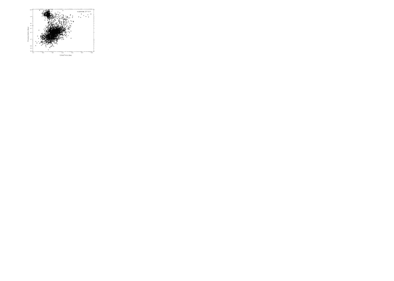

Thanks for your answer! Makes sense that the angular diameter change is negligible considering interstellar distances. Please allow me to pose a follow-up question on the subject: In the mean time i also explored a bit the statistics on exoplanets.eu. I am trying to make sense of the statistics found when plotting planetary radius against orbital period (see attachment). One can clearly see two distinct regions where the number of detections accumulate. This is in the upper left corner (large radii, small preiods) and in the lower left region. The former is probably where the transit method works most efficiently, since large planets block more light and smaller periods allow for quicker confirmation by measuring over several periods. My question would be, what causes the high density of detections in the lower part? Are theses detections via radial velocity? Also why is there a region in between the two denser regions where only a few planets where detected?

Bottom line - I don't know. I notice on this website that you can actually restrict the detections to just transit detections (the green "Detection' pull-down), and it still looks basically the same, so the reason is not what you said.
My guess is that there are simply a lot more planets of small mass compared to planets of large mass.
Good question. I'd like to know the answer to this myself.

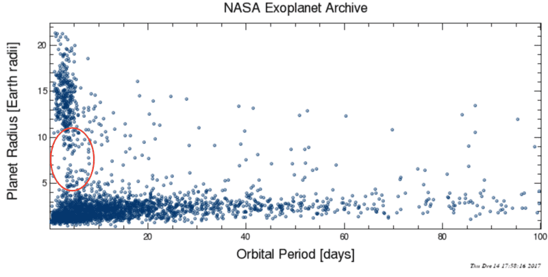

Very interesting question. This planet population trend can also be found in NASA Exoplanet Archive, and it is not observational biases! It is actually an unresolved phenomenon that is not predicted by current theories of planet formation. This gap has many names, such as sub-Jovian desert, super-Neptunian desert, and sub-Jovian Pampas. It lies approximately between Neptune-size and Jupiter-size planets representing the most underpopulated planet desert. It was first described by Szabó and Kiss in 2011. Later, the desert was also found to appear in radius distribution as Kepler collected more data (Beaugé & Nesvorný, 2012). The lack of well-characterized planet in this region prevents us from further assessing the evolution and formation of these planets. One possible explanation is photon-evaporation (Kurokawa & Nakamoto, 2014). In this scenario, the atmosphere of close-in sub-Jupiters and super-Neptunes experiences intensive escape induced by stellar radiation and wind leaving behind the small cores, which are either super-Earth- or mini-Neptune-size. The photon-evaporation model successfully reproduced the observed trend. Another mechanism is runaway gas accretion (Batygin et al., 2016). A planet with mass higher than 10 M undergoes runaway gas accretion, and the mass and radius of the planet increase dramatically and rapidly surpass the desert region forming a Jovian world. In contrast, a planet with mass lower than 10 M forms a Neptunian world, and the worlds in between Jupiter and Neptune are short-lived and very few in number. We still don't know which of these two mechanisms might be responsible for the formation of desert. It could be the combination of both.
