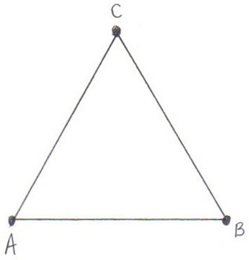

Hi all!
I am still a GR noob and this example has been puzzling me for a while, so I need some help that's hopfully.
Let's imagine that there are stars A and B at 10 LY from Earth (at point C) each and 10 LY from each other.
A signal is sent every year from Earth (C) indicating the beginning of a new Earth year.
Stars A and B would receive such signal at the same time and "synchronize" their clocks.
A twin (Mr. X) is sent on a rocket from A to B carrying the same clock-device and sending the signal out.
Another twin (Mr. Y) is left at A
When X receives a signal, he sets out on a trip "instantly" accelerating to .866 light speed, decelerating to stop at B.
X immediately returns to A in a similar manner.
Contradiction and my limited understanding of GR implies least one of these statements has an error or is an over/under-statement:
(1) After after the trip from A, X arrives at B. During this trip, X should have received 10+10=20 signals from Earth (c).
(2) After after the trip from A, X arrives at B. During this trip, X ages 10 years.
(3) After the return trip A-B-A, X arrives at B. During this trip, X should have received 20+20=40 signals from Earth (c).
(4) During the trip A-B, X observes that its time is running "slower" with respect to C because it received 20 signals while only generating 10.
(5) During the trip A-B, Earth observer at C observes that X's time is "slower" with respect to C because it received 20 signals from X during the period of 40 years.
(6) During the return trip A-B-A, Y observes that X's time is running "slower" with respect to Y because it received 40 signals from Earth and counted 40 years, while only getting 20 signals from X during their trip.
(7) Wikipedia is wrong to state "Time dilation due to relative velocity symmetric between observers"
(8) X's biological clock matches the clock that X carries - clock which is generating signals
Which statement is in error, or is over/under-stated?

What led you to conclude that? Say in the rest frame of the stars, the first signal arrives at A in 2000, and that's when X sets out towards B at 0.866c in this frame. Since the distance from A to B is 10 light years, it will take X a time of 10/0.866 = 11.547 years to reach B in this frame, so he'll arrive in 2011.547. Since X has received the same number of signals that were received by A and B (during his trip he received each signal slightly before A and B since his distance to C was smaller, but the total number is the same), X has received 11 signals when he arrives at B.
If the trip took 11.547 years in the rest frame of A-B-C, and X's aging was slowed by a factor of 2 during the trip, then X aged 11.547/2 = 5.7735 years during the trip.
Takes X another 11.547 years in the A-B-C frame to get back, so a total of 23.094 years, meaning X has received 23 signals.
X only sends out a signal once every 2 years in the A-B-C frame, but the distance from X to C is different for each one, so it's a bit complicated to figure out how many signals C has received at the time X makes it to B. Also, because of the relativity of simultaneity, the answer to the question "how many signals has C received at the same moment that X reaches B" will depend on your choice of frame, it would be different in the frame where X is at rest during the journey from A to B than it would be in the frame where A-B-C are at rest, since these frames disagree about what event on C's worldline is simultaneous with the event of X arriving at B.
kamenjar said:

Again, your numbers are wrong, it would take some work to figure out the right ones and first you'd have to specify what frame's definition of simultaneity you want to use.
It's symmetric between inertial observers, it no longer becomes symmetric if X stops moving inertially and accelerates to turn around. If X was just moving in a straight line forever at constant speed, C's view of X's signals would be just like X's view of C's, though the rate of signals would depend on the amount of time before or after the moment of closest approach due to the Doppler effect which increases the perceived frequency of signals when an object is coming towards you and decreases the rate when it's moving away from you (the Doppler effect has to do with the fact that different signals are emitted at different distances and therefore take different times to reach the other observer--time dilation is what's left when you factor out these signal delays due to the finite speed of light)
Yes, that's true.

You guys simply did an awesome job correcting my calculation mistakes - I got a little carried away in thought .866 means 2x dilation and made a mistake there. Now I get that...
My main issue was with (7) actually, so that's why I came up with the example...

I think the most important point is that X doesn't see C through the side window, but rather through the front window.
Due to aberration, he sees C approaching him at an angle, even if it is straight to his left or right at that moment.
Naturally, an approaching object's light is blueshifted (=shorter intervals). This effect exactly reverses the ratio that you'd expect from time dilation alone.
As X knows about aberration, he'd correct his observations for it and conclude that C is time dilated.

Now I can see where you are coming from and why you presented your thought experiment the way you did.
You should not think that time dilation is merely caused by a doppler shift which is when the frequency of a repetitive signal arrives at a higher rate when the source and destination are getting closer together (aging faster, as you said) and when the frequency of the repetitive signal arrives at a lower rate when the source and destination are getting farther apart (ticking slower, as you said). If that were the case, then your scenario makes sense because you are trying to minimize the doppler shift by having Mr. X travel at approximately right angles to the direction of the signals between him and the earth.
The first thing wrong with your thinking is that the time dilation is related to the direction of motion. It is not. But you are correct that the apparent frequency shift is related to the direction of motion and you might think that it would be best to minimize this to see the real time dilation but that is the more difficult situation in which to understand what is going on because the doppler shift is constantly changing throughout the experiment and the analysis is correspondingly cumbersome.
If you think just about two observers traveling in a straight line that goes between them (your Mr. X and Mr. Y), then the doppler shifts due to their motions becomes fixed values (as long as they are always moving away from each other at a constant relative speed). If there were no time dilation, then I think it might be easy to understand that what each one will observe when receiving the signals from the other person would not be symmetrical. They would both be emitting a repetitive signal at the same rate (and we can assume at the same times) but Mr. X moves away so that by the time he detects the signals from Mr. Y it will take longer than for Mr. Y to detect the signals that were emitted by Mr. X at the same times. So the doppler frequencies without time dilation would not be symmetrical. (If you need more help on this, look up "Doppler effect" in wikipedia.)
But now consider what happens if the moving one, Mr. X, is experiencing time dilation. He will be emitting the signals at a slower rate and so Mr. Y will be receiving them at a slower rate than he would have without time dilation. And Mr. X will be receiving the signals from Mr. Y at a "faster" rate than he would without time dilation because his clock is taking longer to tick. The net effect is that with time dilation of the moving observer, both observers will measure the tick rate (doppler frequency) of the other observer symmetrically, that is, at the same perceived rate. (If you need more help on this, look up "Relativistic Doppler effect" in wikipedia.)
So relativistic doppler is the indirect means by which we can actually measure symmetrical time dilation. It is very difficult to otherwise measure or demonstrate that time dilation is symmetrical. In my analysis of your scenario presented earlier, it was only because of the round trip of Mr. X that I could legitmately make the statement that he was the one who had experienced time dilation and not any of the other observers.
