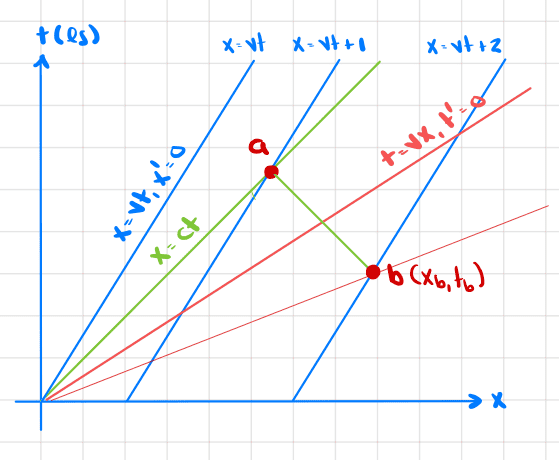

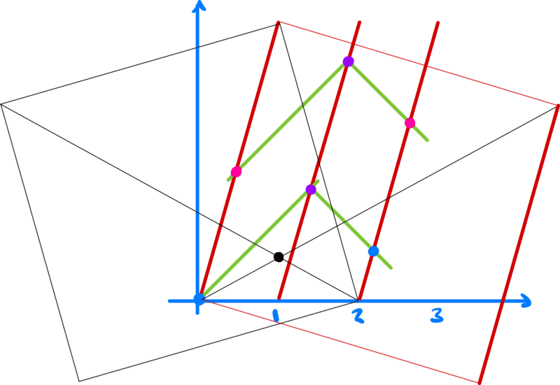

Here is a depiction of coordinates in frame A

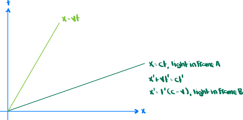

I've drawn in the coordinates of a light ray that is at the origin at ##t=0## (dark green) and the coordinates of frame B if we assume that it too is at the origin at ##t=0## (light green).

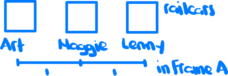

Imagine a moving train with three different railcars each separated by a distance of 1. Art, Maggie, and Lenny are each in one of the railcars.
Each of them has an inertial reference frame, though they are simply offset from each other by a fixed distance. We can consider them all to be frame B.
Let's consider frame A our frame.
Let's use relativistic units (meaning that ##c=1## and we can either think about that number as dimensionless or as, e.g. light-seconds per second).

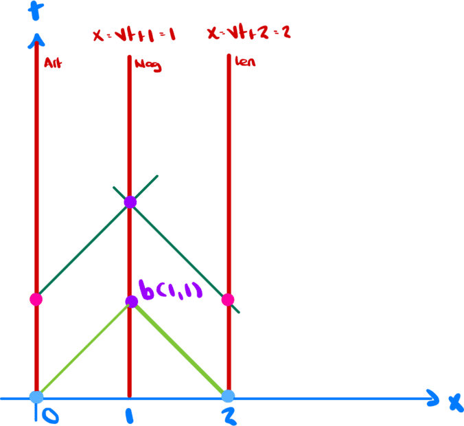

Suppose Art and Lenny both emit a light ray towards Maggie such that the light rays arrive simultaneously at Maggie.
First suppose that the train is not moving. We have the following situation
Since ##v=0## we have
$$x=x'$$
$$t=t'$$
Consider the light green lines.
For the one starting at the origin we have
$$x=t$$
The other one satisfies
$$x=-t+t_0$$
Since they meet at ##b##, which we know is ##(1,1)## we can easily find the equation
$$x=2-t$$
for the other light green line.
Note that a light ray emitted at ##t=t'=0## from the origin and from ##(2,0)## (in both frames) reaches point ##b(1,1)## simultaneously. The two light blue points are synchronized, as are the two pink points.
In fact, any points on any line ##t=t_1## are synchronized.

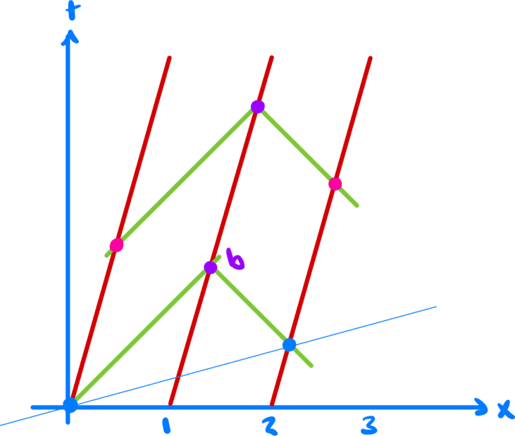

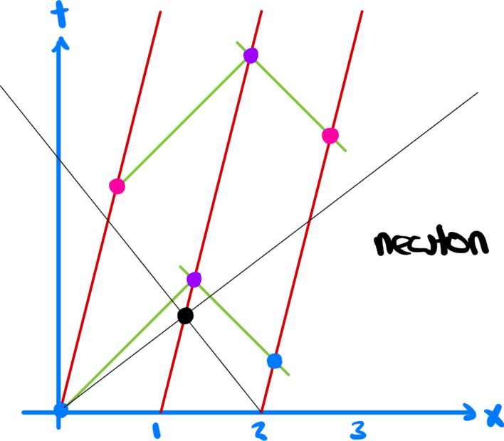

Now consider that the train is moving with speed ##v##.
Again, the red lines represent the position in spacetime of the three railcars in frame A.
Assuming that the speed of light is the same in every inertial frame, then we can draw the green lines at 45 degree angles representing emitting light rays from different rail cars. For two light rays to arrive simultaneously at the second rail car at point b, they need to be emitted at the two light blue points (one by Art and one by Lenny).
Notice that in frame A, the times at which they are emitted are no longer the same. The emission of the rays is not synchronized from the point of view of frame A.
Maggie receives both light rays at the same time, and from her frame both Art and Lenny at at the same distance from her so to her the emission of the rays is synchronized. In fact, since the emission by Art occurs at t'=0 then so does the emission by Lenny.
From the point of view of Maggie's frame, all points on the thin blue line are synchronized with each other.

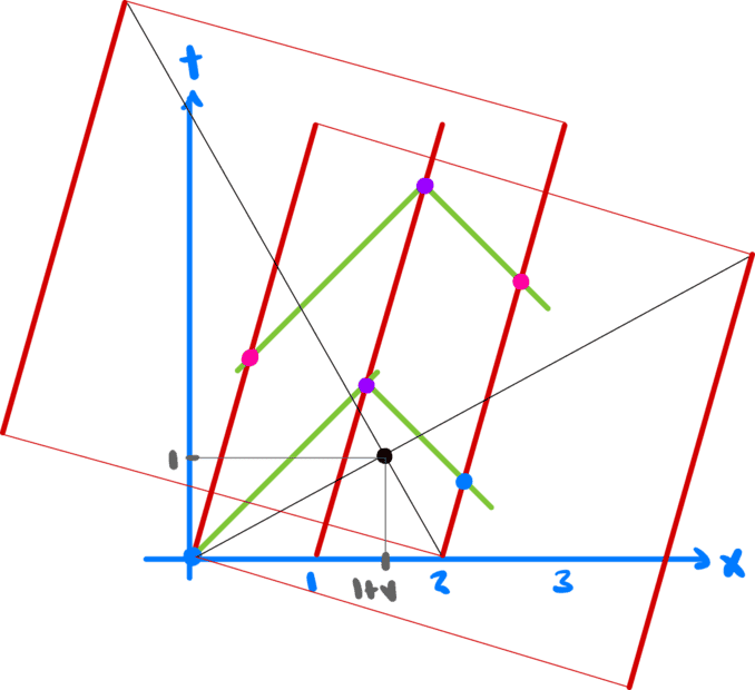

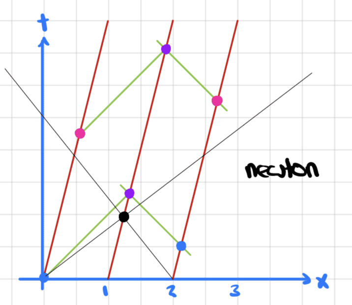

Let's see how Newton would view this situation in graphical terms.
As far as I can tell, we have a situation like
I have drawn the two boxes just to show the symmetry and that in fact the angles are drawn correctly (I think). The point I want to talk about here is the black point.
Notice that I used the gridlines to make the graph precise.
We have here that ##c=1## and ##v=\frac{1}{4}##.
The black line starting at the origin represents the light ray emitted by Art from the point of view of frame A
$$x = (c+v)t=(1+v)t=1.25t\tag{1}$$
In Art's frame we have
$$x'=x-vt=(1+v)t-vt=-t\tag{2}$$
In Lenny's frame we have
$$x'=x-vt=(1+v)t-(2+vt)=-2+t\tag{3}$$
Next, consider the black line starting at ##(2,0)## in frame A.
$$x=(-c+v)t+2=(-1+v)t+2=2-0.75t\tag{4}$$
In Art's frame this is
$$x'=(-1+v)t+2-vt=2-t\tag{5}$$
and in Lenny's frame
$$x'=(-1+v)t+2-(2+vt)=-t\tag{6}$$
(1) and (4) are the black lines in the plot.
They meet at
$$(1+v)t=(-1+v)t+2 \implies t=1 \implies x=1+v=1.25$$
$$t=2-t\implies t=1 \implies x'=1$$
And in Lenny's frame we have
$$-2+t=-t\implies t=1\implies x'=-1$$
All of this makes sense mathematically and graphically.
What it means is that under Newton's transformations the origin is synchronous with ##(2,0)## in all frames, which means that a light ray emitted from these two spacetime points reach the equidistant purple point at the same time.
So why is this problematic?
Because measurements of the speed of light in any of the frames shows is constant: ##c=1##.
Thus, equations (1) and (4) are incorrect since these equations show a speed of light of 1.25 and 0.75, respectively.
When we make the assumption that the speed of light is constant in every frame, we end up with the green lines in the picture above and now the two blue points are synchronous in the moving frames. They are not synchronous in frame A.

Finally, there is also the ##x'=0## axis
What does it mean that the ##x'=0## axis and the ##t'=0## axis are not at a right angle?

zenterix said:
What does it mean that the x′=0 axis and the t′=0 axis are not at a right angle?
Nothing. The geometry of spacetime is not Euclidean.
Instead, the spacetime geometry is that of Minkowski space, which has a different inner product. With the Minkowski inner product, the ##t’## and ##x’## axes are indeed orthogonal. It just won’t look that way when you draw them on a piece of paper with an inherently Euclidean geometry.
Edit: Note that the ##t’## and ##x’## axes are not orthogonal in the case of the Galilean transform either when drawn in the unprimed system. There it means even less though.

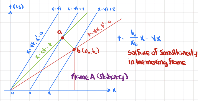

One thing I have doubts about is the following, in the context of the three railcars. Consider the following picture
In this picture the third railcar is at a further distance from the middle railcar. As one would expect, the farther away the third railcar is the sooner the light ray has to be emitted from that railcar to reach the light ray emitted from the first ray car.
But then, in the moving frame, is point ##b## above simultaneous with the whole orange line that we had previously determined was the ##t'=0## line?
In fact, are all points on the line passing through ##a## and ##b## simultaneous all the points on the orange line?
Now, I think the answer is no but I can't express exactly why.
I think it has to do with the fact that it is know that the distance between the first railcar and the middle railcar, and between the third railcar and the middle railcar is different.
I guess I don't understand how distance is baked into the notion of simultaneity.

First let's look at how simultaneity is represented on a Minkowski diagrams: Draw a straight line through two events. If that line is parallel to the x-axis of a given frame then those two events and all other events on that line are simultaneous in that frame. This makes sense when you consider that a line parallel to the x-axis is a line of constant ##t##, which in turn follows from the fact that the x and t axes of a frame are orthogonal in the Minkowski geometry even if the don't look that way on a Euclidean sheet of paper.
