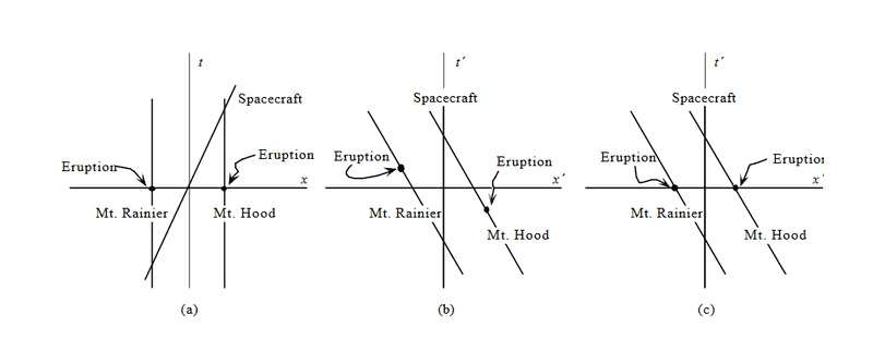

Here is a quote from the second paper. Sherr asked several versions of the same basic question, I am only going to give one of the four versions of the question.
Scherr said:
... two volcanoes,
Mt. Rainier and Mt. Hood, that erupt
simultaneously according to an observer at
rest on the ground, midway between the
volcanoes. A spacecraft moves at a given
relativistic velocity from Mt. Rainier to
Mt. Hood.
Spacecraft Question: Undirected version
The students were asked to draw
spacetime diagrams for both the ground and
spacecraft frames. They were told to show
the volcanoes, the spacecraft, and the
eruption events. They were not asked
explicitly whether the eruption events are
simultaneous in the spacecraft frame.
Rather, we inferred their ideas indirectly
from their diagrams.
Following are correct and "typical" incorrect space-time diagrams for this question from Scherr's paper. Of some concern is whether or not you are familiar with space-time diagrams. They're not hard, if you're not familiar I'd encourage you to read about them. They illustrate some important points about special relativity that are hard to explain otherwise.
a) is the correct space-time diagram for the ground observer, b) is the correct space-time diagram for the spacecraft observer, and c) is a "typical" incorrect space-time diagram.
