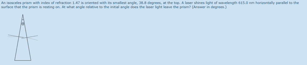

See attached
Snell's law
So what I did first was made the face of the triangle flat and calculated the angle the light entered it. This means the light enters the triangle from the base corner angle (so (180-38.8)/2) of 70.6 degrees.
1sin(70.6)=1.47sin(angle)
angle=39.915
Now I need to find the angle it exits. But this part doesn't make sense to me because Ill just be left with my original angle.
1.47sin(39.915)=sin(angle)
angle=70.6 degrees
The answer is suppose to be 20.3. I am obviously messing up with the geometry of the problem though I am not sure how. Trigonometry I was never good at.

In the standard form of Snell's law, the angles are to the normal. Does it look like the ray enters at 70 degrees to the normal?

By normal, I mean the normal to the surface the ray is passing through. The diagram shows the normal as a dotted line.
What is the angle the ray makes to that on entry?

Im not sure, that's what's making me not get the answer. would be 180-38.8 then divided by 2 = 70.6
This would be the angle at each bottom corner. And if I rotate the tringle so the side the light hit is flat, its a rotation of 70.6 degrees.

That gives you the angle the base of the prism makes to each side of the prism. Since the ray comes parallel to the base, it is also the angle between the ray and the side of the prism.
But you want the angle between the ray and the normal to the side of the prism.

Normal to a surface means at right angles to it. If the ray is at angle θ to the surface then it is at angle π/2-θ to the normal..

Yes, the angle is between the laser and the dotted line (perpendicular to the flat side of the triangle). I understand that, but I don't know how to find such an angle.
So your saying its pi/2-angle, but what angle?

Draw the prism.
Point A is the apex of the prism, B the lower left corner and C is the lower right corner.
What is the value of angle ABC?
Point E is where the ray hits the prism. D is where the ray has come from.
Draw line DE.
What is the geometric relationship between lines DE and BC?
What is the value of the angle DEB?
Line FE is the normal to the prism at point E.
What is angle FEB?
So what is angle FED?
