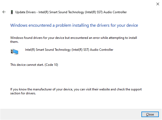

No audio output device detected
I opened up my lappie today to discover that it will not play any sound.
Says there are no audio output devices installed.
I went through various Google suggestions, including pointing it at my system drivers (Device Mgr > System Devices > Hi Def Audio > Update > Choose from my drive) and then rebooting, but no joy.
Suggestions?
Only thing that I've changed recently is a little more use of my headphones. It asks what kind of device I'e just plugged in. This has worked fine before, so I don't know how it's related to this problem.

Yeah.I found that first DriveEasy one and walked through it. Didn't help.
In the comments though, someone suggested closing the lappie rather than rebooting it. I tried that, though still had to reboot after, and it seems to be fine now.
Windoze magic.

Yeah, sometimes you need to shutdown vs reboot as not everything gets reset in a reboot.

Try rolling back drivers (if Windows allows you to do so). Also disable and then enable the driver.

Anyway, it's magically fixed.
Windows has consistent driver collision issues, when an updated version of the driver tries to install and for various reasons makes the system confused about which version to use. People who have been around for awhile are always prepared for a clean reinstall. The truly paranoid virtualize everything.

For me, the problem occurred long after I had already removed the headphones (that had been working fine) - the next time I woke it up.
Putting it to sleep, rather than rebooting seems to have fixed it.

I've seen this several times. Its basically Windows being stupid with drivers. I always go to device manager and uninstall the driver. Then restart computer. Be connected to internet so Windows can just install them again.
