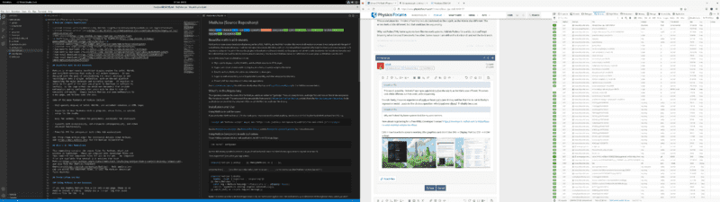

pbuk said:
It looks mighty fine on my new 2560x1440 screen

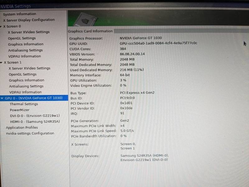

Still can't get a screen to work on the DVI port, but otherwise

Edit: both screens now working (the graphics card didn't like DVI -> Display Port but DVI -> HDMI is fine).

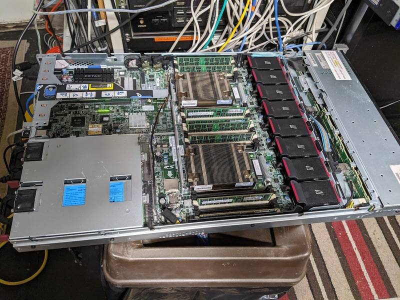

If you want a cheap server class Linux machine upgrade the used HP machines on the market are great with a GT 1030 as the video card. A little noisy for a home office without fan hacks but solid as a tank with full redundancy.
HP ProLiant DL360p Gen8 1U RackMount 64-bit Server with 2×6-Core E5-2640 Xeon 2.5GHz CPUs + 64GB PC3-10600R RAM + 8×300GB 10K SAS SFF HDD, P420i RAID, 4×GigaBit NIC, 2×Power Supplies, NO OS
Under $300.

You are right, there are some great buys out there if you don't mind noise and age. A while back a number of 28C56T servers were on the market - great if you could use them, but keeping this many threads busy is not trivial.
