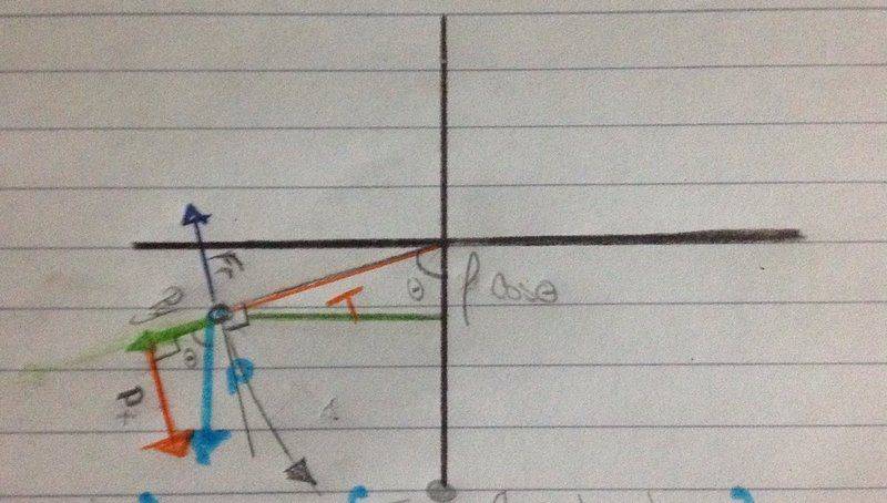

I used the usual Consideration of Forces, using an X and Y plane supportive towards l⋅Cos(θ) and l⋅Sin(θ) respectively as can be seen from the picture:

for example, is the velocity used in the kinetic energy the tangential one?
There is no radial movement, so yes.
