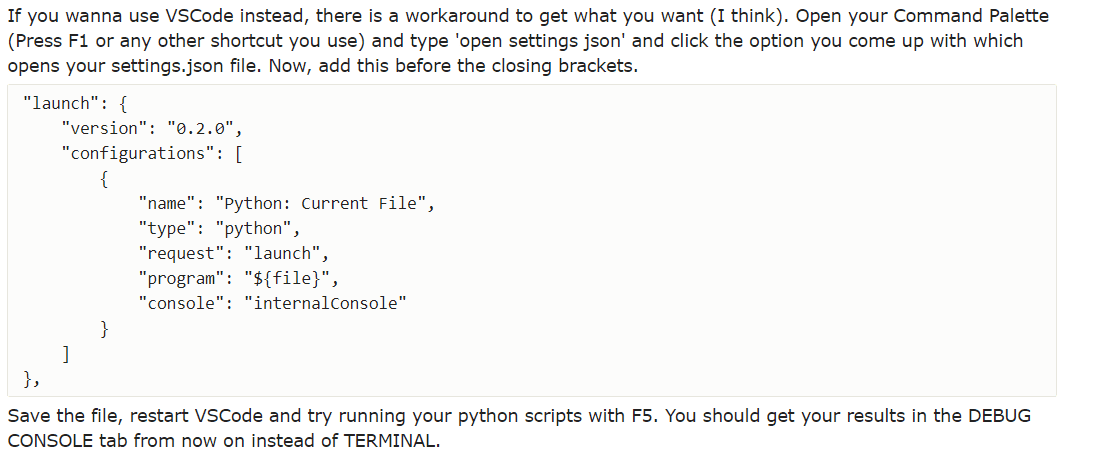

There is vs code but it shows that terminal code which is annoying to me. Is there a way to remove those cmd codes there and just see the output.

PyCharm is great but it's a pretty intense program meant for professional developers. Based on what you've shared I would not recommend you use it. I love VS Code for Python. What is the output you see that you are trying to remove?

someone got that..and helped me. I was trying to hide that terminal output that comes like C;/users...cd...bla bla..
I think I should go with VS code. But loved pycharm..looks like that's meant for high end laptops...
I have opened it for an hour. It hasn't restarted till now..so ig it's good.
Awesome! You can customize so much about VS Code, one of the many reasons I like it for Python work.
