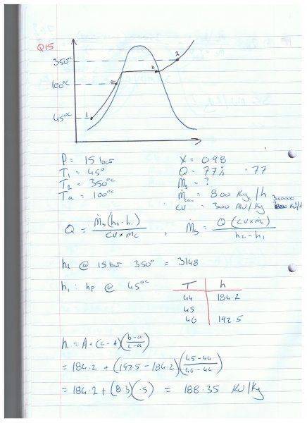

Im attempting this question for an evening class I am attending. hope I am posting in the right place. I'm not sure where I have gone wrong think its where I rearranged my formula to find steam output.
Question attached below

I think I calculated the steam output wrong, I have the over all efficiently of the system 77%, what formula do I use the calculate steam output?
Q=M(h2-h1)
Yeah that's the one..!
For calculating the steam output, you can directly use the 77% efficiency without involving the economizer and super heater (if I'm not wrong).
So 77% of the heat obtained from the combustion of coal is used to convert water to steam.
77% is the overall efficiency am I right ? So did I divide .77 by h2-h1 to get steam output?
Yes! And equate it with the energy provided by the combustion of coal. Tell me if that gives the right answer.
6244.09 kg/h
I meant did you get the right answer?
