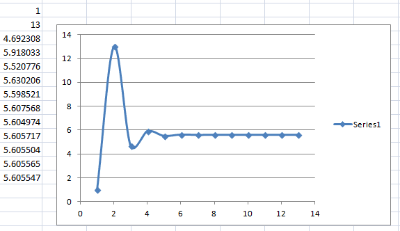

So here's the equation [itex]x^2 -4x-9[/itex], with an input of 1.
For the recurrence equation [itex]x = \frac{9+4x}{x}[/itex], here is the plot of number of recurrences (n = 1,2,3) and the value it produces
(its in Excel, I am lazy)
As you can see, there is a damped curve, which is underdamped (I hope I got that right, been a while since I took Circuits for RLC stuff)
Anyway, as n approaches infinity, it reaches one of the zeros for the equation of 5.6ish

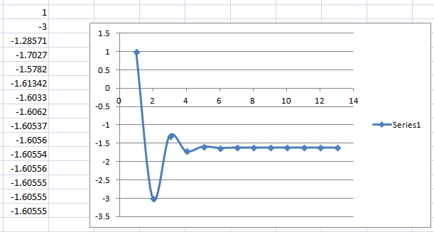

Now, if we manipulate the recurrence function to be [itex]x = \frac{9}{x-4}[/itex], here is the plot
Also underdamped... and gets to the -1.6 zero of the quadratic function

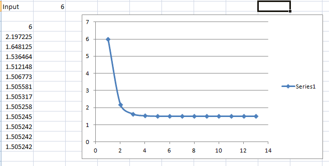

So... how about x = ln(x+3), can we find some overdamped or critically damped?
Well, here is that recurrence function with two different inputs
Im not sure if this is critically damped or overdamped...
I thought this was interesting to note, as (and I am not an expert on damping systems), we could probably describe this in a Second ODE...
