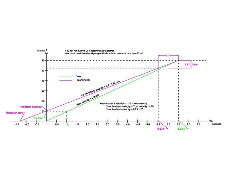

You can run 9.2 m/s , 20% faster than your brother. How much head start should you give him in order to have a tie race over 60 m ?
SUVAT
Attempt is attached, thanks for the help :)

Error in first line: What is 20% faster than 7.36m/s?

What is 20% of 7.36? What do you get if you add that to 7.36?

I think we have zeroed in on the issue. EDIT @haruspex pointed this out in post #3.
josephn said:
Homework Statement: You can run 9.2 m/s , 20% faster than your brother.
Write that out as an equation:
##V_{you}=9.2 = 1.2 V_{bro}##
then ##V_{bro} = \frac {V_{you}} {1.2}##
josephn said:
isnt it just 9.2m/s?
@haruspex is asking you do do the calculation to check you result of 7.36 m/s for your brother's speed.
What is 20% of 7.36 ?
Take that result and add it to 7.36 .
What do you get?
It's not 9.2. is it ?
