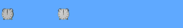

The distance between Earth and Star T is 100 lys.
The clock is synchronized for A and B

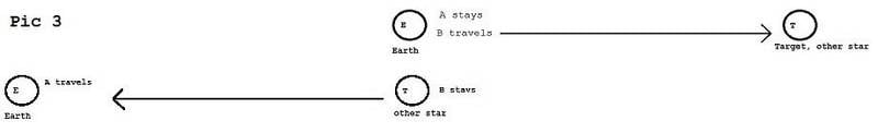

But motion is relative, right?
A would have tought that it's A who moves, B stays.
Or, please compare Pic 3
Why B experience time dilation, while A not?
Isn't motion relative?

There is no such symmetry because the movements are not symmetric. Remember than in special relativity there are some frames that are specials, the inertial frames. If you go outside those frames, then you are outside the special relativity.
In this case, one of the twin stays in an inertial frame, while the other have an accelerated movement (at least at one point in his trajectory) .
So, there is nothing wrong with computing different times for A and B since they movement where not qualitatively the same...that is what I think at least.

You have to account for length contraction. In picture 3, where you have E and T moving while B is at rest, you have to apply length contraction to the distance between E and T and B will measure this distance to be 50 light years, so for him, T traveled 50 light years at 0.87c, which took 57.75 years. To complete the picture you need to take the relativity of simultaneity into a account also. If in picture 2 you have clocks on E and T that are synchronized to each other.( both read 0 when B leaves E and Both read 115 years when B reaches T), these clocks are not synchronized in picture 3, the frame in which B is at rest, In this frame E reads 0 when B leaves, but T already reads 86.125 years. As T travels towards B and E away from B, they both age 1/2 as fast as B for a total of 28.875 years. Thus when T reaches B its clock reads 96.125+28.875= 115 year and the Clock on E reads 28.875 years.

With your one-directional example, you still have asymmetry between your ship and planet frame: the origin and destination are defined in the planets' frame. This means that, in the ship frame, the distance between the planets is length contracted.
So: in the planet frame, the ship has 100ly to travel at 0.866c, so it takes 100/0.866=115y to get there. However, the ship is in motion with a Lorentz gamma factor of 2. It is length contracted (which is irrelevant to this scenario) and time dilated - so its clocks will record 115/2=58y of travel time.
In the ship frame, the planets are moving, so they and the distance between them are length contracted - so the destination planet only has 50ly to cross to reach the ship. At 0.866c, this takes 58y by the ship's clocks. The planets' clocks are time-dilated in this frame, so they accumulate 58/2=29y during the crossing.
Note that both frames agree about the time accumulated by the ship's clock in the crossing (although their explanations for why it reads what it does differ). However, they disagree about the time on the planets' clocks. This is because relativity put "now" on the same footing as "here" - it means different things to different people. There's no ambiguity about the time taken according to the ship's clocks because you are using one clock. There's ambiguity in the planets' clocks because there are two clocks and two frames with different definitions of what "now" means. According to the planet frame, both planets started their stopwatches simultaneously and recorded 115 years while the rocket travelled. According to the ship frame, the destination planet started its stopwatch 86 years early and accumulated 29 years in the crossing, so it reads 115 years when the ship arrives. The origin planet started its stopwatch, accumulated 29 years during the crossing, but then left it ticking for another 86 years for some reason.
