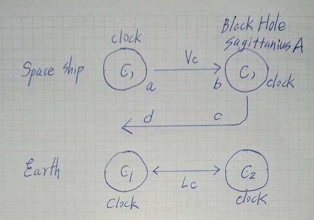

I saw a book that uses special relativity to solve the twin paradox, the inference process is roughly as follows.
Suppose a spacecraft sets off from the Earth to travel to a distance black hole and then return to the earth. We divide this process into three stages, that is, the process of navigating to this black hole (a→ b), the short moment of reverse turning (b→c) and the process of homing (c→d).
Vc = speed of the spacecraft , in light year
Lc = distance between the Earth and the black hole, in light year
The following is from the perspective of an observer in the spacecraft .
When he reached the black hole (a→ b), he found that the time of C2 was ##\left( \frac {L_c} {V_c} \right) ##, but he doesn't think this is the time elapsed by the observer on earth, because he thinks that the time of C2 is already ## \left( \frac {V_c L_c} {c^2} \right) ## faster than the C1, so the actual elapsed time of the Earth should be ## \left( \frac {L_c} {V_c} -\frac {V_c L_c}{c^2} \right)##
The moment the spacecraft turns to go in opposite direction (b→c) , he found that time of C1 suddenly changed from ## \left( \frac {V_c L_c} {c^2} \right) ## behind C2 to ## \left( \frac {V_c L_c} {c^2} \right) ## ahead of C2, so the time on Earth suddenly increased by ## \left( 2\frac {V_c L_c} {c^2} \right) ##
When the spacecraft returns (c→d), the Earth also passed time ## \left( \frac {L_c} {V_c} -\frac {V_c L_c}{c^2} \right)##
So in the end, the observer in the spacecraft thinks that the total elapsed time of the observer on the Earth is ##\left[ 2 \left( \frac {L_c} {V_c} -\frac {V_c L_c}{c^2}\right) + 2\frac {L_c V_c} {c^2} = 2\frac {L_c} {V_c} \right] ##, which is elapsed time by the observer on the earth.
On the other hand, the time elapsed by the observer in the spacecraft can be calculated from the observer on the Earth according to the time dilation, which is ##\left[\left( 2\frac {L_c}{V_c} \right) \sqrt {1-\frac {V_c^2} {C^2}} \right] ##
The final conclusion is that the ratio of time elapsed on Earth to the time elapsed in the spacecraft is ## \frac {1} { \sqrt {1-\frac {V_c^2} {C^2}}} ## , so for this twin brother, the brother who came back from the spacecraft is younger than the brother on earth.
I admire the above derivation process described in this book, but I still have a question in my heart, because the uniform linear motion is relative, why the observer on the Earth can’t think that the spacecraft is not in motion, but it is actually he carries the clock C1 Move in the opposite direction with the earth? So in this case, will observers on Earth come to the completely opposite conclusion? :smile:

The situation is completely symmetric while the motion is uniform, but this is not such a case.
For accelerated motion, the twin who turns around is different from the twin who stays on Earth. There are a few ways to accept this:
From a purely physical, real-world, point of view, the traveling twin feels the acceleration when he turns around. The stationary twin never feels acceleration.
From a purely mathematical point of view, the traveling twin knows that he does not remain on a non-accelerating path in a single space-time reference frame. He changes his space-time reference frame.

The Lorentz Transformation and the rules on time dilation and length contraction apply when measuring in an IRF (Inertial Reference Frame). In this scenario, the Earth remains approximately at rest in the same IRF throughout. The rocket, on the other hand, is at rest in one IRF on the outbound journey and at rest in a different IRF on the inbound journey.
When you analyse the experiment from the rocket's frame of reference you must (by some means) take this change of IRF into account. You can't simply pretend that the rocket has been moving inertially throughout.

Suppose you were flying from Las Vegas to Denver. I imagine you wouldn't be at all surprised that if you flew straight from Las Vegas to Denver, that your total air mileage was shorter than if you took a detour to Albuquerque, i.e. if you flew from Las Vegas, to Albuquerque to Denver, you'd have more air miles. And you'd say the reason is simple, that the shortest distance between two points is a straight line.
If you were to draw a space-time diagram, you should come to a very similar conclusion, with one important distance. While the shortest distance between two points in a Euclidean plane is a straight line, for timelike curves on a space-time diagram, the "straight line" path the longest path, called in some references the path of "maximal aging", rather than the shortest path.
Because of one's knowledge of Euclidean geometry, it's obvious to most people that the shortest distance is a straight line. It's not really intuitive that on a space-time diagram this is the path of maximal aging, which is the opposite of what one would expect from the analogy. But from the spatial analogy, it's clear that in general there is no reason to expect that taking a detour will not change the total path length, and that "straight line" paths are different from "bent" paths.
The "triangle paradox" corresponding to the "twin paradox" is obviously not a paradox at all, in fact it's usually called the triangle inequality, which says that the hypotenuse is shorter than the sum of the other sides of the triangle. There is just no reason to expect that the total path length will remain the same when one takes a detour. The interesting difference between the geometry of Euclid and the Lorentzian geometry of space-time is that in the former, one uses the pythogerean theorem where ##ds^2 = dx^2 + dy^2 + dz^2##, while in the space-time case, one uses the space-time line element ##d\tau^2 = c^2 dt^2 - dx^2 - dy^2 - dz^2##

Is the spacecraft supposed to turn around using its own rockets, or use the black hole's gravity to do it?
If the latter, this scenario cannot be analyzed using special relativity.

My own imagination is that no matter what energy the spacecraft uses to propel it, the steering of the spacecraft is to use black hole gravity or nuclear fusion force, etc.
If by "steering" you mean "changing direction relative to the original starting point" (which is Earth in your scenario, but really should be imagined as the stay-at-home twin floating freely in space, since Earth itself is a gravitating massive body and would make the scenario not analyzable using special relativity), then you are quite wrong, it makes a huge difference whether the spacecraft changes direction by firing its rockets--which means it feels the force of the rockets pushing it--or by a gravitational "slingshot" maneuver around a black hole--which means it is in free fall the whole time and feels zero force. The first case-- spacecraft fires rockets to turn around--can be analyzed using special relativity (and that is probably the case the book you read had in mind). The second cannot.

The general idea in the twin paradox is that the turnaround, however it is achieved, has a very short duration compared to the outbound and inbound journeys. The major factor in terms of differental ageing between the traveling twin (younger) and stay-at-home twin (older) is the overall journey time - this is easy to calculate. A minor factor is the difference caused by the precise physical nature of the turnaround.
To describe the precise details of a gravitational turnaround requires GR - as GR is the relativistic theory of gravity. But, this will give you only a minor correction to the overall differential ageing. Note that the gravitational time dilation of the black hole will be negligible for 99% of the journey, so we can treat the outbound and inbound journeys as effectively inertial motion in approximately flat spacetime - which is the domain of SR. This is what I did in the analysis above.
If you are learning SR, then you should treat the gravitational slingshot as just another turnaround mechanism. An understanding of that in itself will have to wait until you have learned enough SR to progress to GR.

Doesn't a long, far, trip keep them at different gravitational potentials longer and with greater differences? It seems more complicated than just the effect of the turnaround.
Not really. For an interstellar space flight at relativistic speed, the dominant factor is the relative velocity over a period of years. If you simply slingshot round a black hole then you have a short period (a few days perhaps according to Earth) where there is significant gravitational time dilation.
For the typical scenario you have a differential ageing of, say, 10 years plus or minus a few days perhaps depending on whether you calculate the effect of the turnaround itself.
Note that including up to four realistic acceleration and deceleration phases at a proper acceleration of ##1g## would be significant, as each of these phases would take a year or two. That would change the calculations somewhat, but the not overall conclusion that the traveller would be younger on return.

alan123hk said:
Moreover, the analysis method mentioned in this book seems to assume that all the acceleration and deceleration times of the spacecraft are extremely short, so the influence of these processes is ignored, and the special theory of relativity is used reasonably for analysis. So whether this space uses the gravitational force of the black hole to change the navigation direction does not seem to have much influence on this matter.
Precisely.
