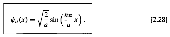

Boxed equation: psi_n(x) = sqrt(2/a) sin(n pi x / a), labelled [2.28].
a) For this part, I know for distinguishable particles, the expectation value of the square distance

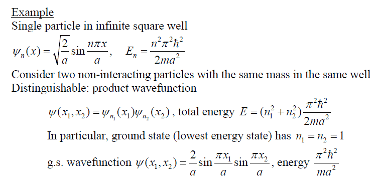

Handwritten-style typed notes showing the infinite square well single-particle wavefunction psi_n(x) = sqrt(2/a) sin(n pi x / a) and energy E_n = n^2 pi^2 hbar^2 / (2ma^2), then two-particle product wavefunction and total energy formulas for the ground state.
Handwritten-style derivation of symmetric and antisymmetric two-particle wavefunctions for indistinguishable particles in an infinite square well, with normalization A = 1/√2 and lowest-energy cases n1 = n2 = 1 and n1 = 1, n2 = 2.
For part (a), note that your potential well extends from x = 0 to x = a. Thus, you will integrate from x = 0 to x = a. Note, though, that Griffiths' integrals extend from 0 to ##\pi##. So, a change of integration variable will be required if you want to use Griffiths' integrals.
For part (b), the website that you link to assumes that the well extends from x = -L/2 to x = L/2. That causes some of the wavefunctions to be cosine functions. But, in your case where the well extends from x = 0 to x = a, all of the wavefunctions will be sine functions.
The answer you got in part (a) can't be correct because the units don't work out.
You should review how to construct the symmetric and antisymmetric spatial wave functions. It's pretty straightforward how to do so. You shouldn't need to copy a result off of a webpage.
