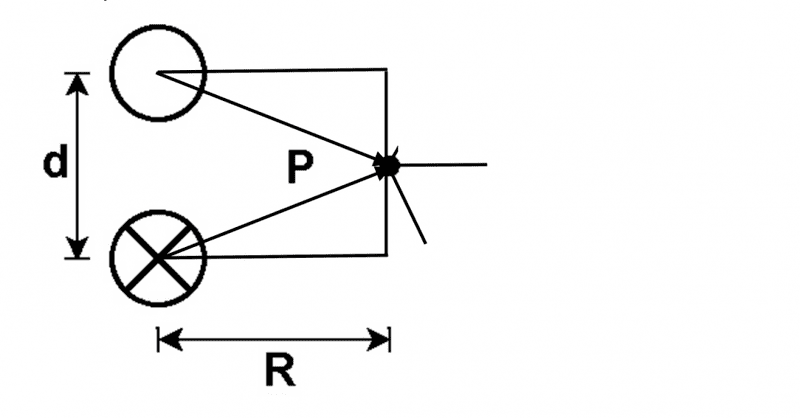

Two long parallel wires are a center-to-center distance of 1.10 cm apart and carry equal anti-parallel currents of 9.70 A. Find the magnitude of the magnetic field at the point P which is equidistant from the wires. (R = 10.00 cm). (See Attachment for orientation)
I = 9.7 A
Distance from current source = √(.12+(.011/2)2) = 10.015 cm
Binfinite wire= μi*I/2*pi*r
Knowing the upper wire's magnetic field rotates counterclockwise and the lower wire rotates clockwise using RHR 2. So the y components at point P are equal but opposite. So we know the magnitude at Point P is going to be 2 times the x component of the magnetic field produced by either wire, which is represented as...
Btotal=2*μi*I*cos(θ)/(2*π*√(.12+(.011/2)2))
where cos(θ) = .1/√(.12+(.011/2)2))
So Btotal = 3.868e-5 T but it is telling me that is wrong.
Thanks for any help, it is greatly appreciated.

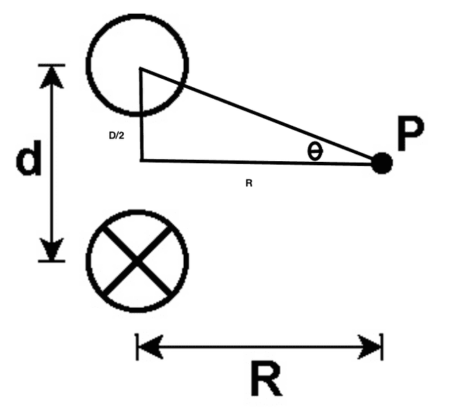

here you go
The θ in this diagram is not the angle you want to use in cos(θ) for calculating the net B field. Did you draw the B fields for each wire?

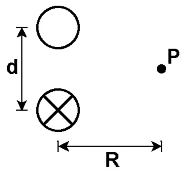

so the top wire would be counter clockwise and the bottom would be clockwise. the y component of B for the top wire points up and the y component of B for the bottom points down, don't they cancel?
Yes, they cancel.
But you need to draw the arrows representing the B-field vectors at P for each wire so that you can see the angle they make to the horizontal.
is the angle 45 because it will be tangent to the field line? aka there is a 90 degree angle between the two components
The B vectors are tangent to the circular field lines, but why would that produce a 45o angle? You might try making several sketches for different positions of P. Do the B vectors make the same angle with respect to the horizontal for all positions of P?
okay so it isn't 90, I the angle for the field will be the other angle in that triangle (see sketch), but when I tried it, it too gave me the wrong answer.

just kidding I plugged it in wrong.
Thanks for your help!
